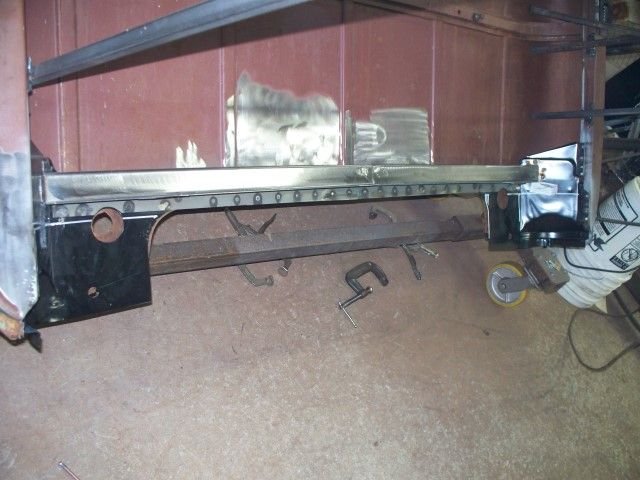

There was another thread on this same subject not too long ago and I posted a sketch of an easy way to fab one up using a length of 1 1/2 " square tubing and pieces of sheet metal ..I'll see if I can find the thread from about 2-3 weeks ago..this I made in 2 pieces because of the width of the metal brake I have

That looks good. I wouldn't be opposed to making out of tubing or making it in two pieces.

with tubing you could go from side to side, weld a flap on the back to meet the cab back bottom and another flap on the bottom to tie in with the floor..

Thanks. That doesnt look like it would be to difficult to make. Definitely an option.
Man look at you...that looks great
