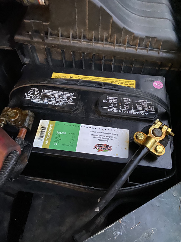

I've had this truck for 2 years. The batteries that came with it appear to be reconditioned. After letting the truck sit for a week or two it doesn't have enough juice to start. It's really kinda unpredictable. Pretty frustrating when you have something you use not all that often and when you need it you can't depend on it. One thing I've had a hard time with is the battery cable connections coming loose. The lead was worn down on the outside where the nuts tighten the clamp. My Dad came over and we were talking about it and he suggested I take a file and file away some lead on the inside of the clamp where the bolt passes through. I cleaned up all clamps, filed them so they fit tighter and replaced a clamp on one wire. I installed 2 Costco Interstate batteries and it cranked and started faster then I've heard it the whole time I've owned it, ever after I would charge both batteries. This is such a relief. I've been putting off dealing with this for a long time, spent an hour on it and it's amazing. Just thought I'd share.

These trucks need a lot of power to start, that is for sure. Well done and thanks for the pictures, we love to see them.

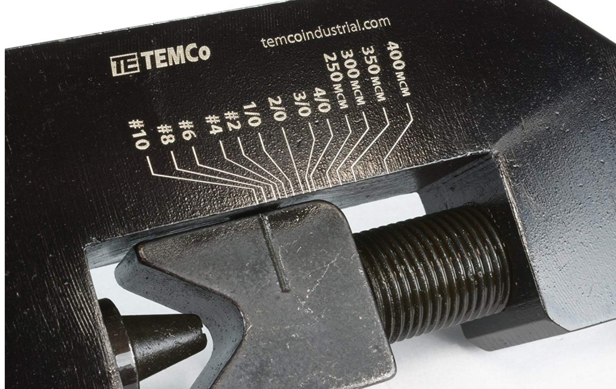

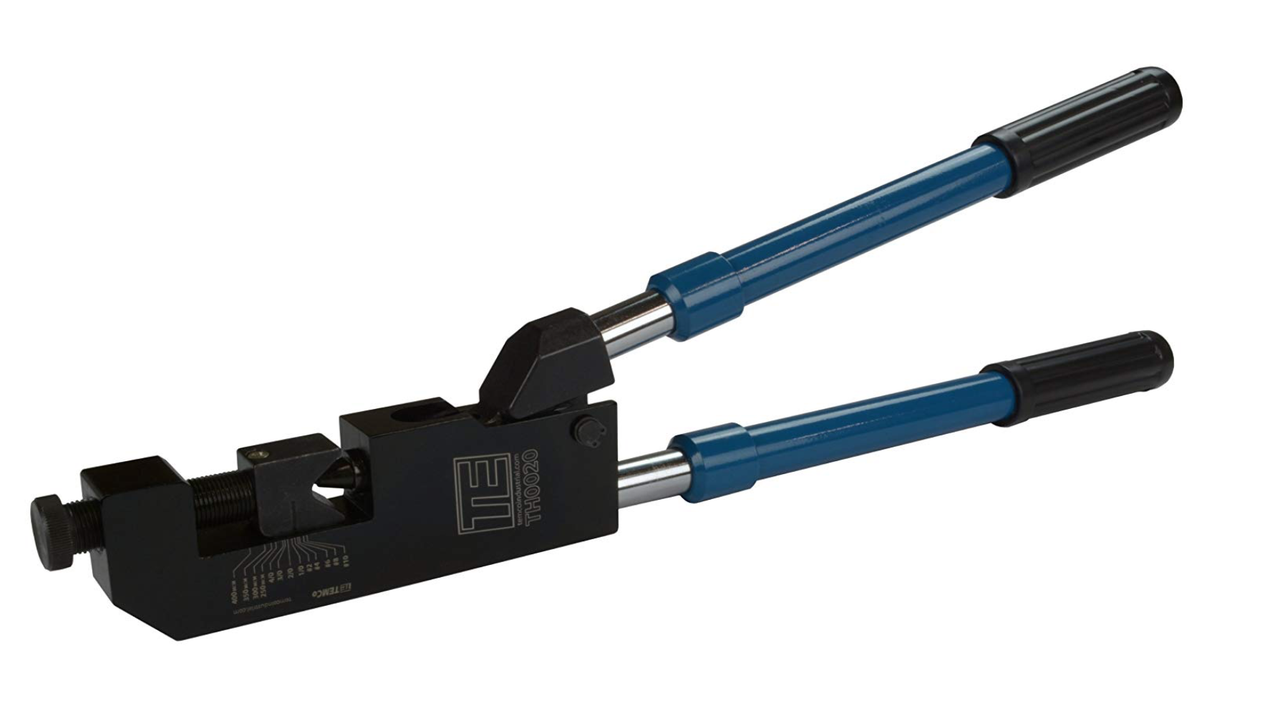

I bought this one, it’s a beast! It’s close to 24” long, think crimping leverage and probably weighs 4-6 pounds. It crimped the 4/0 lugs effortlessly. The nice thing about this style of crimper is you can do crimps on the vehicle assuming that there’s room for the crimper The Intent Crimping Method eliminates the need to select (guess) die size and there’s no dies to lose.

Picking the correct die size is often a guessing game because they’re not labeled by cable size. The indent crimper I bought is labeled by cable size and and can be micro adjusted, has a 5 year warranty and creates a solid crimp. The bottom of the picture shows a Cross section of a crimp using the indent crimper.
I figured for $60, if I use it only a few times it’s paid for itself.
