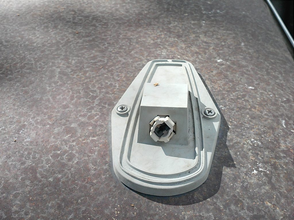

Funny seeing this topic, I was just telling myself a couple hours ago that I need to get back to this particular project myself. My 77 F-150 has some pretty rotten cab lights on it and I wanted some new ones. I'll tell you what I'm doing to "fix" this issue.
My lights appear to be OE as well, they have tags on the wiring with Ford all over them. I was able to source a cheap set of cab lights from Amazon that perfectly match what was on the truck, except the opening where the bulb plugs in. The opening is shaped smaller than it needs to be to fit the factory plugs, so I'm going to take out a small rotary tool, such as a Dremel, and open them up and they should fit my factory lighting just perfectly. The set I bought came with it's own harness that you can splice into the factory one, but I'm trying to avoid modifying the wiring. Otherwise all you'd have to do is make a couple of cuts and a few crimps and you can use what came with the set.
I unfortunately didn't take a shot of the new cab light's opening, but maybe I can take a pic later if I remember to. I'm just linking pics I took a long time ago back when I got these. I've been slacking.

I'm not clear on what the Yankee 77 brand light base looks like and whether you need a full amber lens of only the smaller front lens, but if they're full teardrop style you can go the route of picking up a cheap set from harbor freight. https://www.harborfreight.com/mercha...-pc-64988.html
This is what I did to replace the cracked and faded amber lenses on my 75 F-250.
I only used the lenses/gaskets and threw everything else from the kit away.

I believe they look like this, which is a bit more pointed than the ones you linked. They are available NOS on Ebay, but they are certainly not cheap if he goes that route. Those HF lights certainly wouldn't be bad if originality wasn't a concern. Definitely inexpensive.

An option to consider. Check out the 2017/18 Ford Super Duty amber roof clearance marker LED lights, I used them to replace my 77 F-150 OEM lights. I like the OEM Yankee roof clearance marker lights, but couldn't find good condition OEM replacements, so I went with the 2018 LED lights, and they cast a good amber shadow on my antenna, plus IMP I think they look good.
Note the 2017/18 Ford OEM amber LED roof marker clearance lights use one hole in the center of the light, not two holes like the OEM Yankee lights and a slightly larger hole to enable the the wiring connector to mate into the light socket. Think I paid around $34. a piece from my local Ford Dealer.
