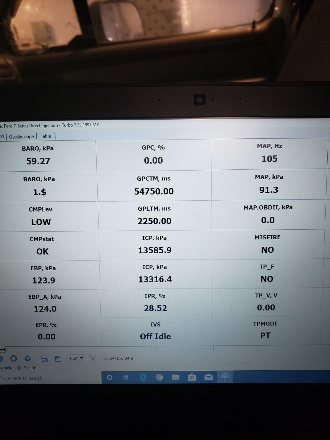

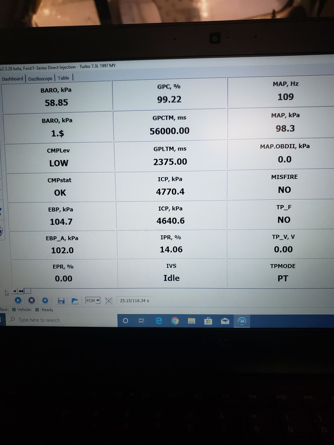

So ran some tests today on map sensor and my voltage readings will not change. 5 v constant and 2.5 to pcm ground is good put some air pressure to map no change in voltage replaced map same exact readings. Not much for pressure off intake as well. No boost at all not even the slightest whistle from turbo nothing on gauge at all even at WOT. Am I wrong in thinking that the turbo is just junk? HELP! cant keep dumping money in this thing.

no power no boost
trying to upload forscan file

i dont think you have the right PIDs chosen and not much in the file

In vermont believe it's only 1000 to 4400 above sea level. Changed map and baro same readings I'll try uploading again but may have to post pics of idle and WOT
