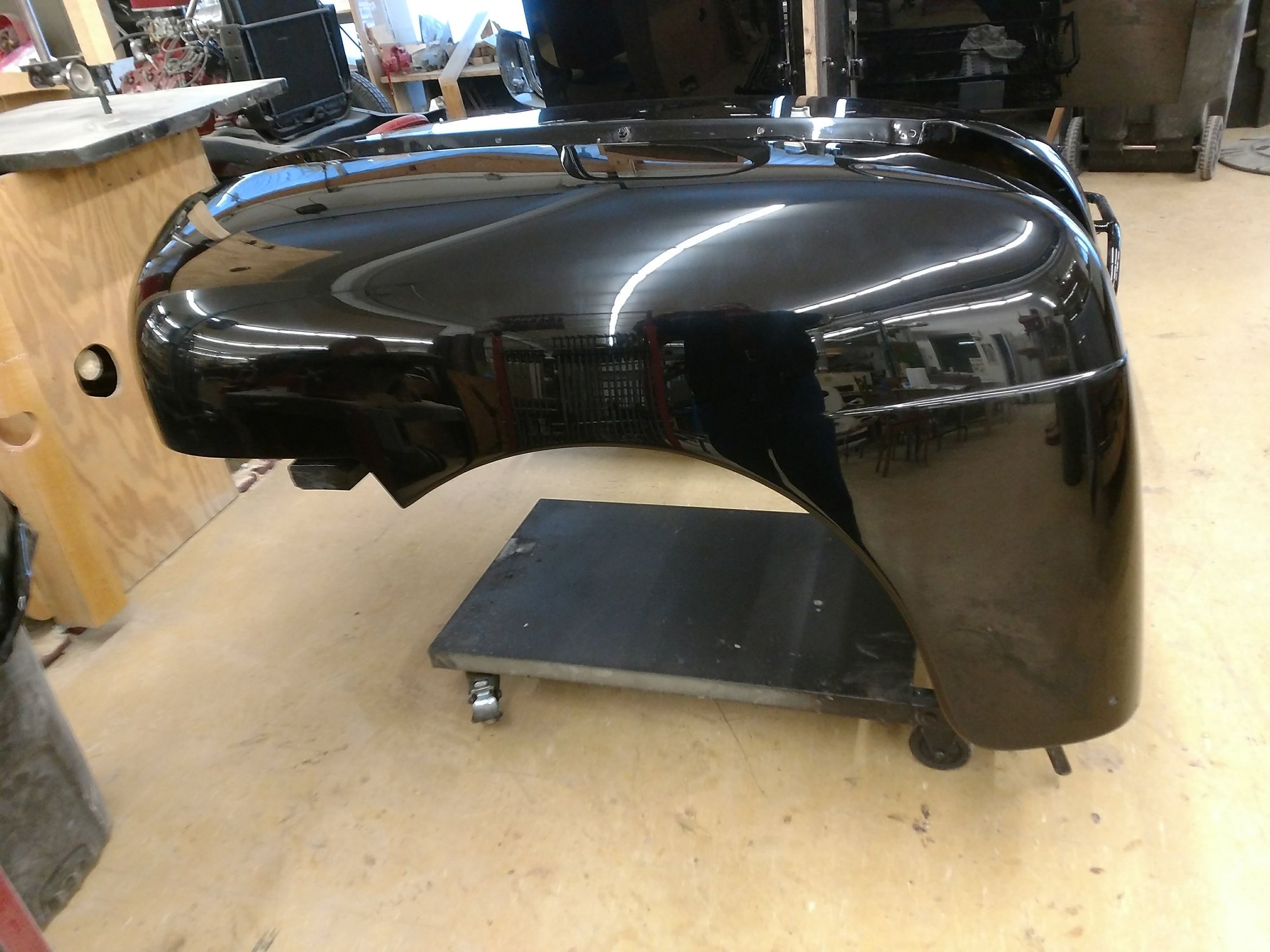

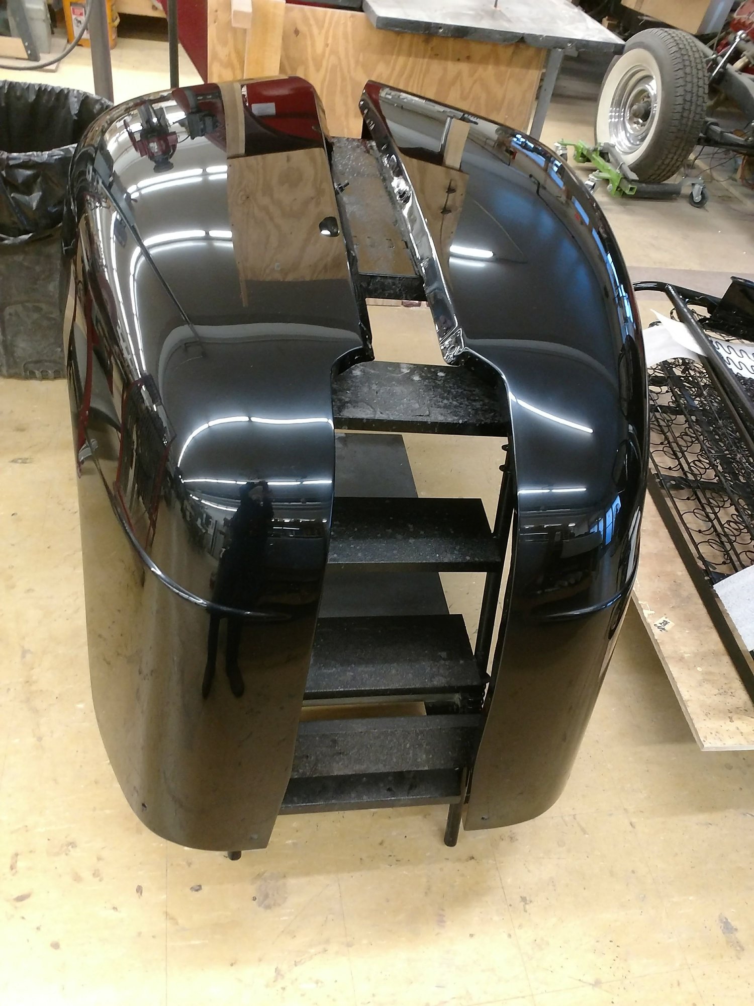

I painted my truck in pieces, then assembled the finished parts.
In order to keep everything organized and not take up all of my shop space, I made various carts to hold parts during paint and initial cut and buff. For fenders, I primed inside and out, did all of my bodywork to each on the bench, then shot a final coat of primer. I masked off the exterior of each fender and shot the inside with Raptor bedliner; if I were to paint them, I would do it the same way. When the Raptor was dry, I unmasked the exterior, masked the inside of the fenders, then mounted them to a special cart I had made. This held them securely and kept them from flexing as I did my final blocking, additional primer, bodywork, etc, then paint and cut and buff.
Fenders Mounted to Cart.
I did the same for the doors.
Doors Mounted to Stand.
The cab was mounted to my rotisserie, but could have been put on a custom stand.
Cab Mounted to Rotisserie.
It made life a lot easier, as well as protecting the parts from damage that could easily occur if they weren't secured. It just took a little bit of thought and planning on my part.

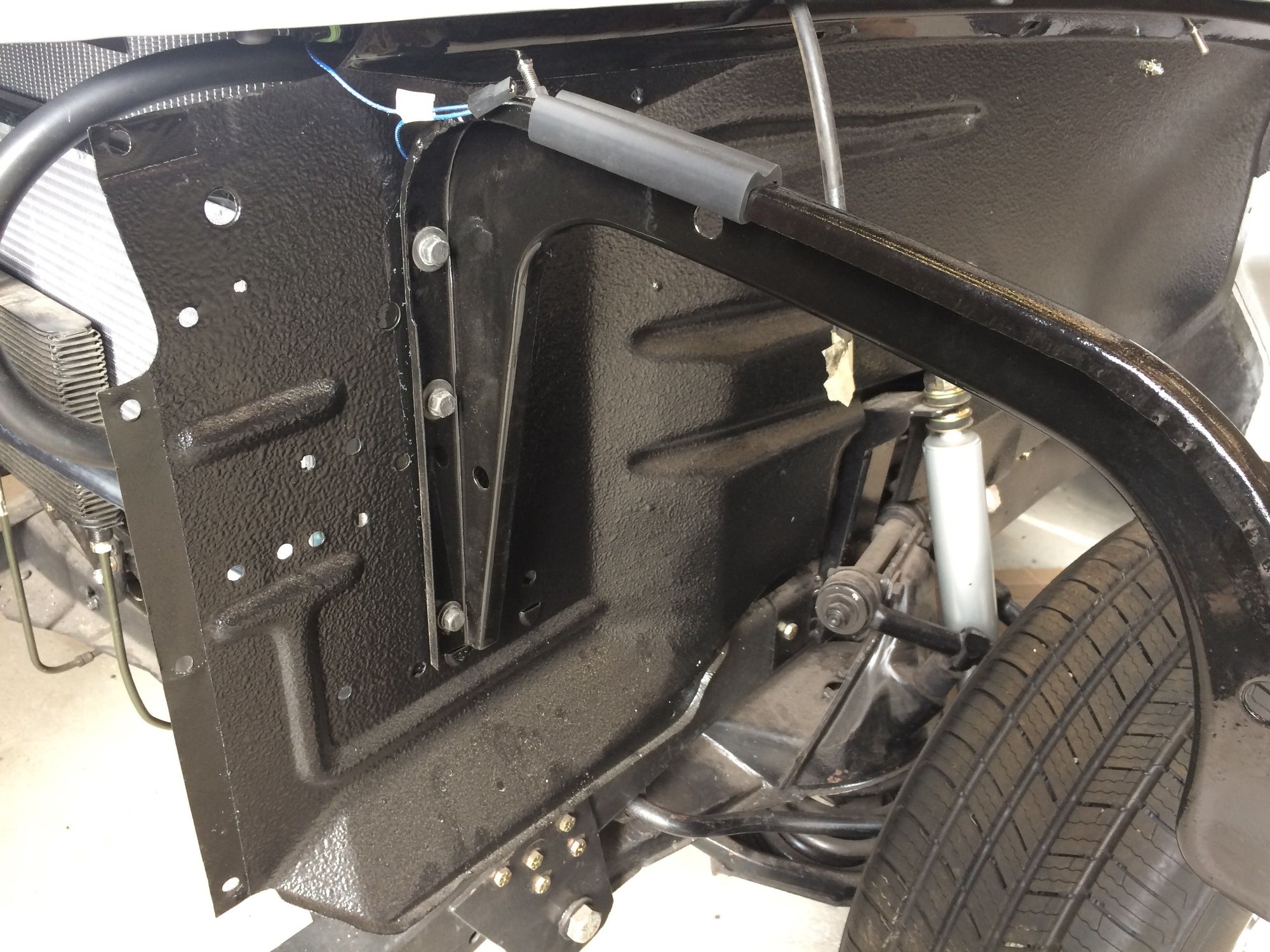

I used a product called KBS then bed liner over that, I masked at the sheet metal connections too prevent them from being to wide or thick from the bed liner
