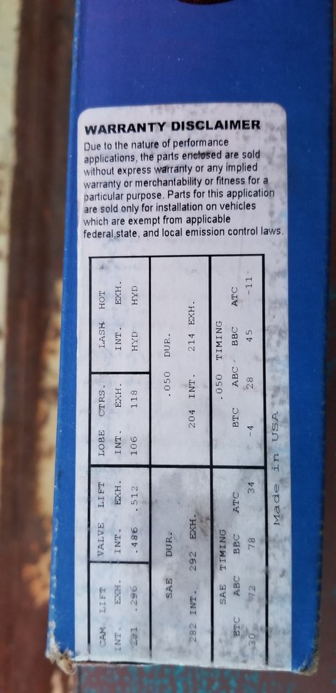

I'm sitting right around 3000ft above sea level. High desert in central oregon. Cam is

If you're at 3000 feet that will drop the average manifold vacuum about 3", so maybe 17" would be typical for a stock engine there.
A "mild" cam, not too sure about what that might do, but it should be close if it's not too radical. Has to do with valve overlap. Perfomance camshafts are tuned for high RPM. This is why the really radical camshafts aren't very good for a street driver, they don't run smooth till north of say 5,000 RPM, they won't idle well, etc. Who installed the cam? Was it degreed in to be sure where it's at?
Another factor, is where the cam is installed. An aftermarket cam is usually installed "straight up" but may have several degrees advance ground into it. Valve timing is different than ignition timing, but it also affects average manifold vacuum. Even a stock camshaft can be advanced and will improve low end grunt, useful for trucks, rock crawling, and higher altitude. A big part of tuning is just measuring and knowing for certain where all this stuff is. Compression, timing curve, manifold vacuum, and proper carb baseline setup and tuning, jetting etc. After a while it'll even seem like ya know what yer doin'!

Sounds like you may have a vacuum leak somewhere, but it could be something else too. I'd be willing to bet the Edelbrock carb isn't your problem. Other than for troubleshooting, the Holley is best for wasting gas. A double pumper will pour gas down the carb every time you accelerate. They also leak like crazy, especially if they sit for any length of time. My favorite aftermarket carb is the Summit aluminum 600 based on the extinct Holly 4010, based on the Autolite 4100. The specs on your cam are fairly mild, but if it was made in China, quality is likely poor. It could be ground wrong. Did you also install new lifters? Did you test them to make sure the plungers work? If the lifters are acting like solid lifters instead of hydraulic, the valves my not be seating when they should, resulting in a much larger overlap than what the spec sheet calls out.
