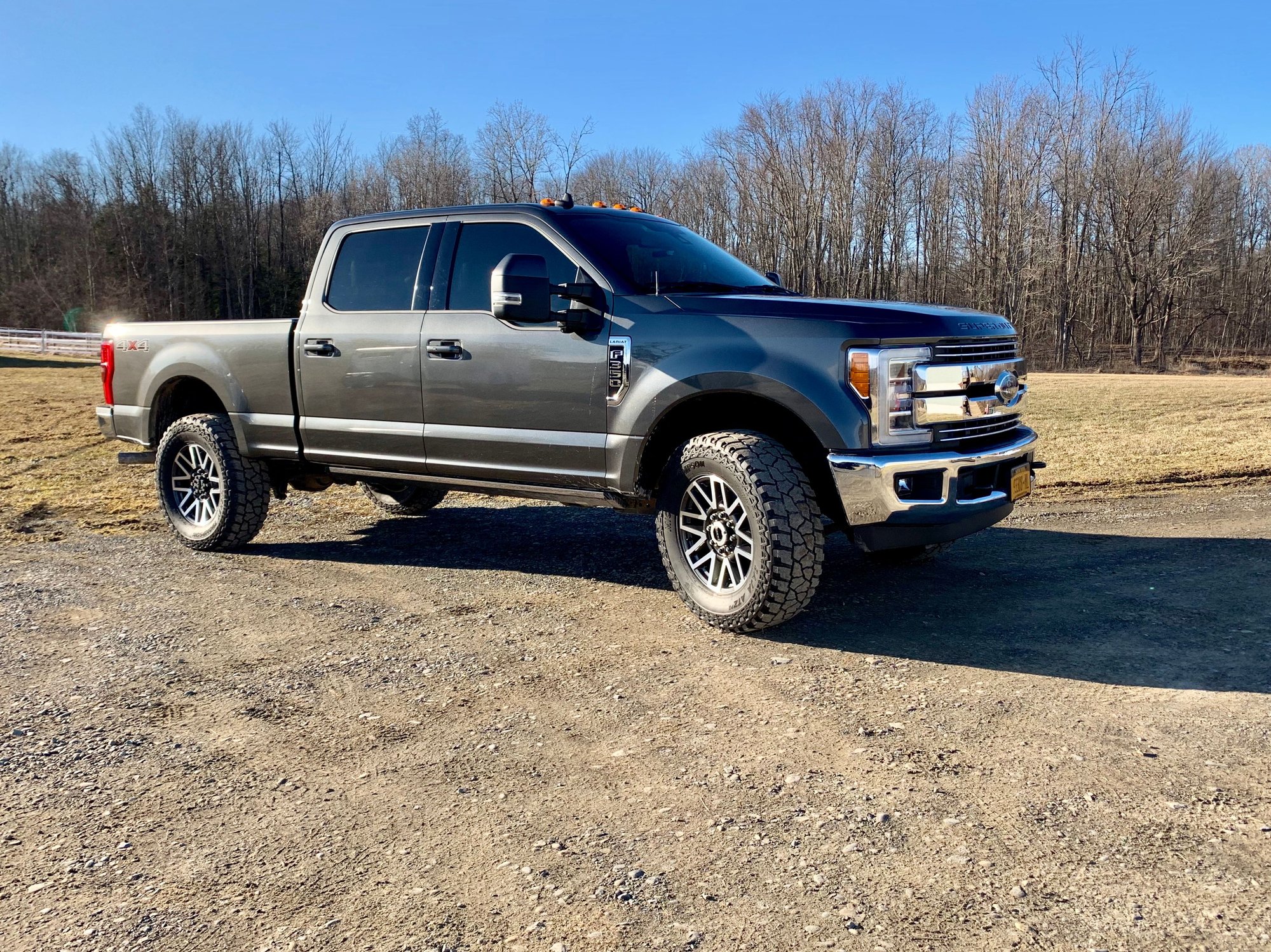

I got bored one day and trimmed my valance. Removed and tossed the Prius catchers. I had the valance removed entirely for a while but didn't like the raw look of the pinched metal under the bumper, especially with bolts sticking out. I measured in several areas around the bumper and made lots of marks because I'd be cutting by hand, very slowly. It looks great from 15 feet but if you get up under you can tell it's obviously not perfect. This is more than okay by me because it cost $0 and fills in the raw metal look perfectly.
