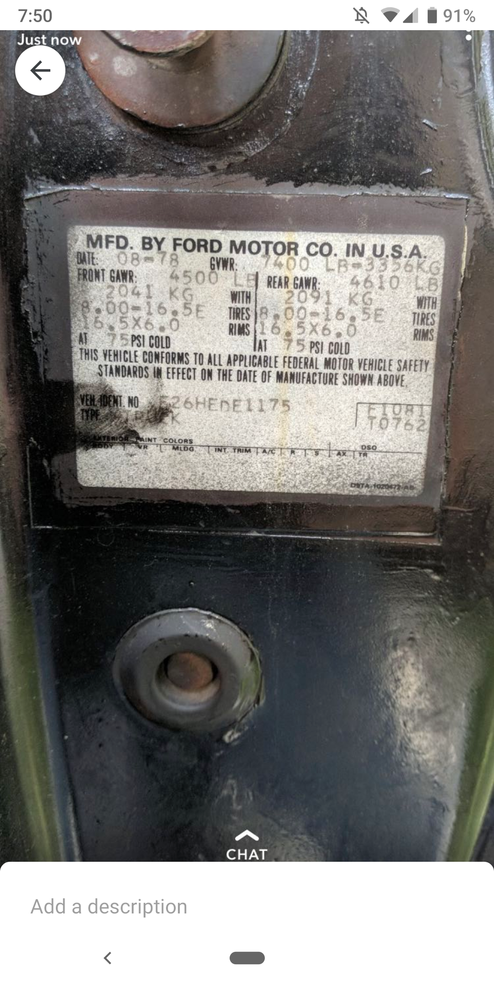

Ok so I'm 90 percent sure my 79 F250 Ranger is a SnowFighter but I wouldn't mind getting some second thoughts. I've read some of the other threads but they still leave me unsatisfied with my current situation. What I'm 100 percent sure of is that it has factory cab lights and a factory Dana 60 up front. Not sure how to tell for sure if I have an upgraded heater core and the trim peice around the heater has been replaced so I'll never know if it had the tag. The truck had 2 fuel tanks stock although it only has 1 now. Thoughts?
