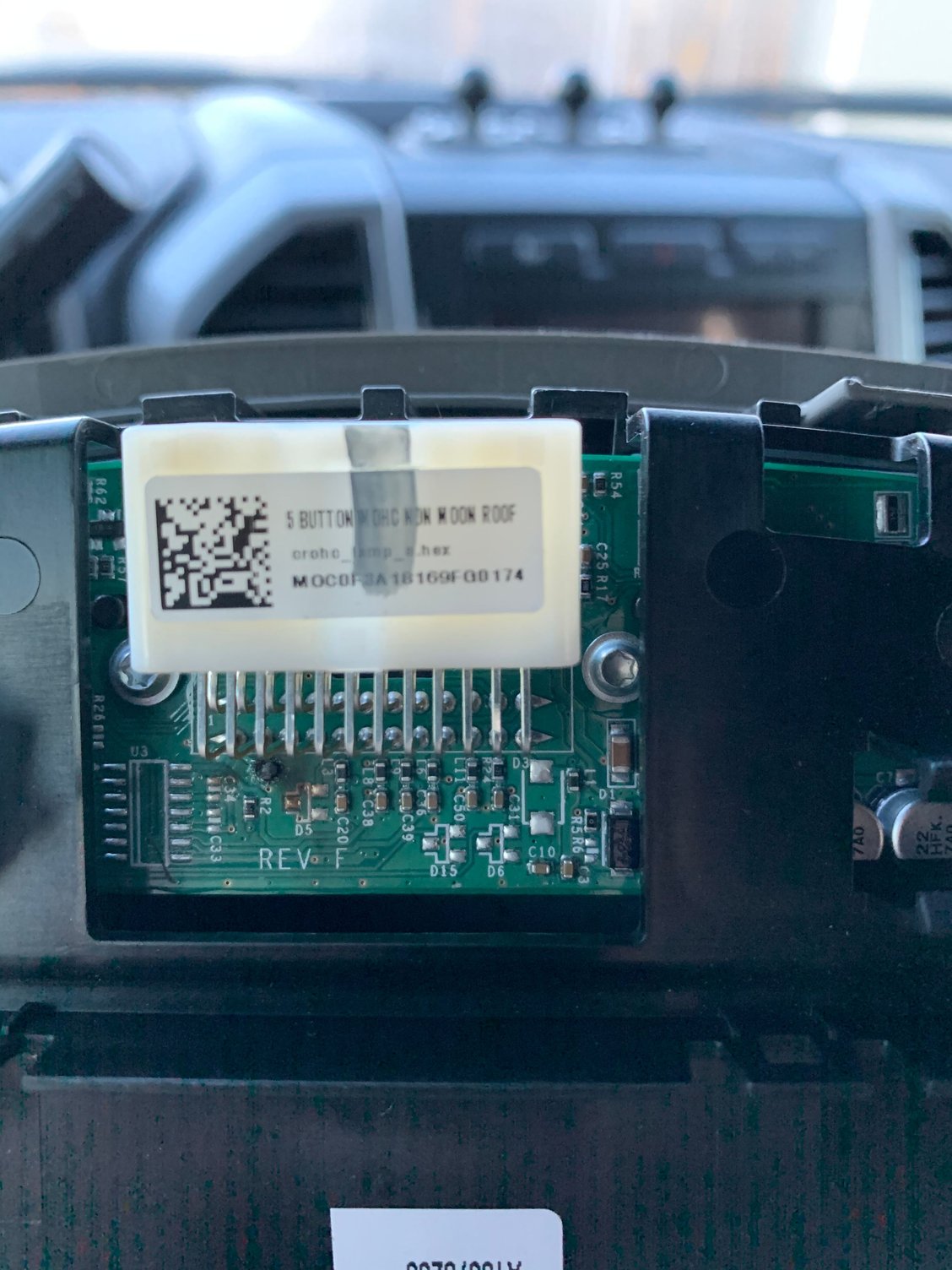

Well... pulled the unit down. It’s fried.
this will be fun sorting out with the dealer...

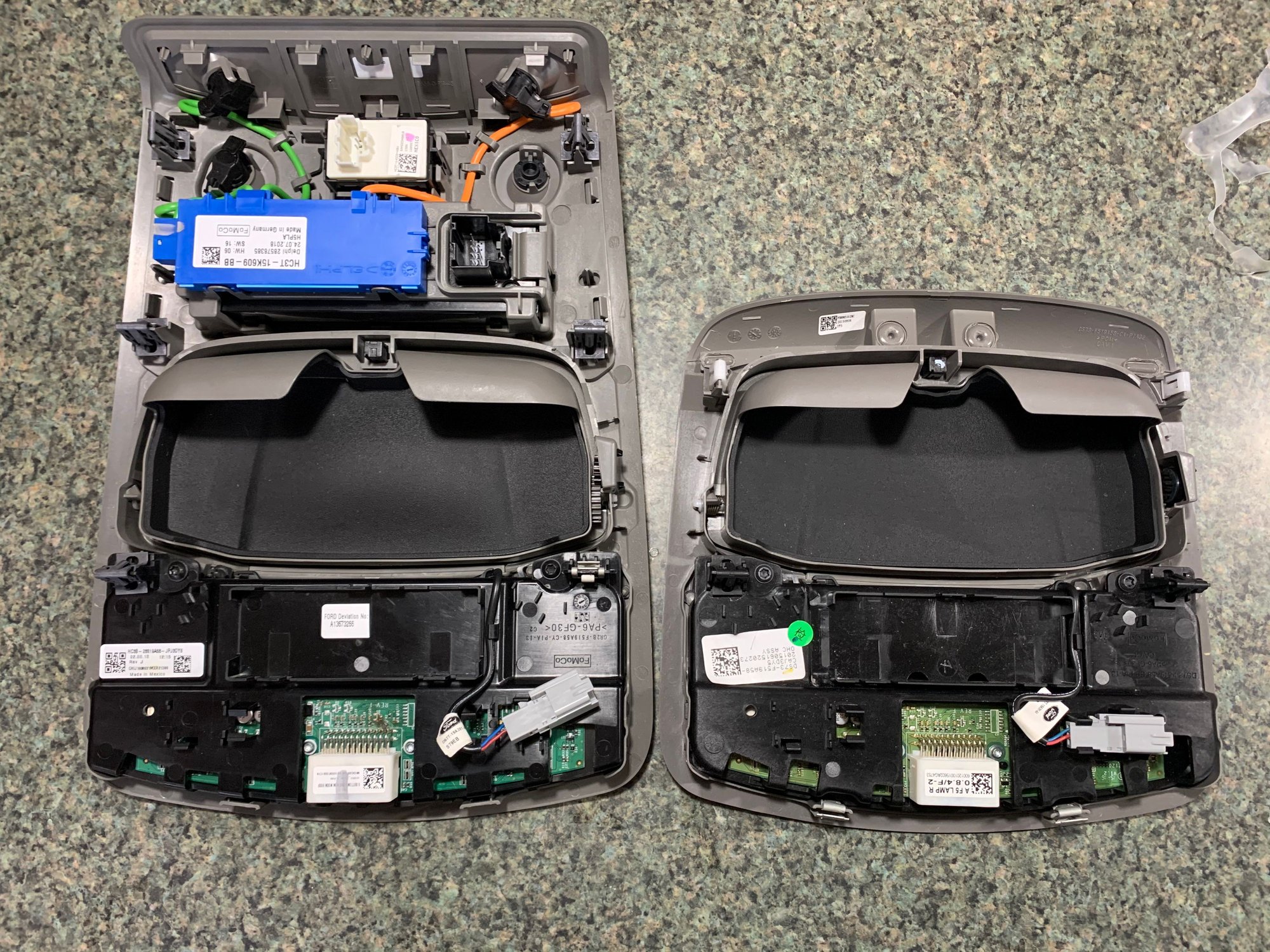

Took a gamble that f150 part would interchange. Success.
