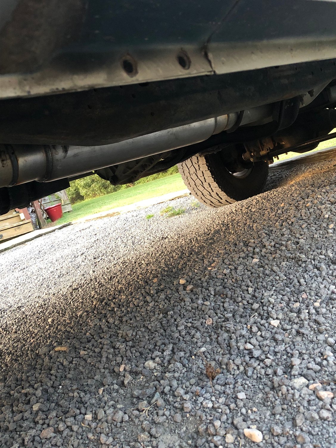

Well after waiting on Fedex for a couple of days, my resonator finally showed up. I just went to my local exhaust shop and got them to weld it up.
Initial impressions...the drone is GONE. All I hear now is turbo, engine, and tire noise. It definitely took some of the exhaust note away, but it still sounds good when I'm romping on it. EGT's seem to be about the same, but I haven't towed with it yet.
Next on the list is the hutch mod to try and quiet the injectors down a little.

Where did you put it?
Old Aug 9, 2019 | 09:07 PM
Jo7.3's Avatar
Jo7.3
Joined: Apr 2016
Posts: 850
Likes: 114
From: Virginia
About 10-12 inches behind the tranny cross member. I was gonna put it a little further up, but it would’ve hit the crossmember.

Nice looking weld, muffler shop done good!
