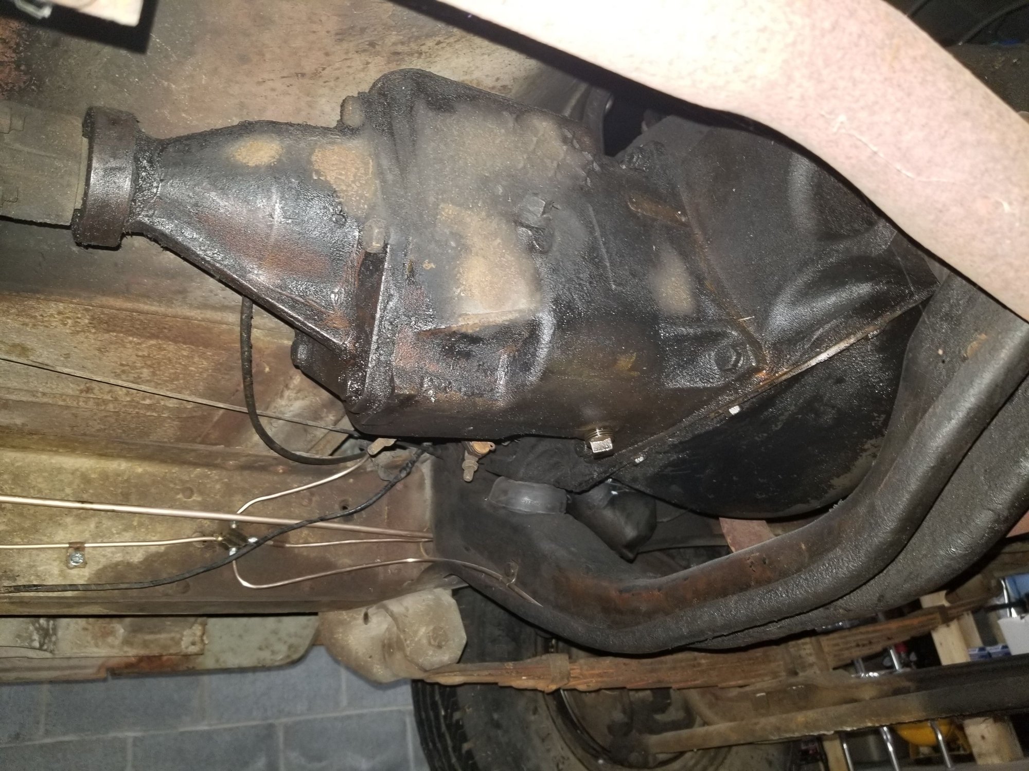

The one you posted looks very similar, this is what I've got.
Thanks to both of you. Sounds like this should be a piece of cake then. With my luck, something will go wrong though. But as long as it all gets back together I'll be happy ha.
