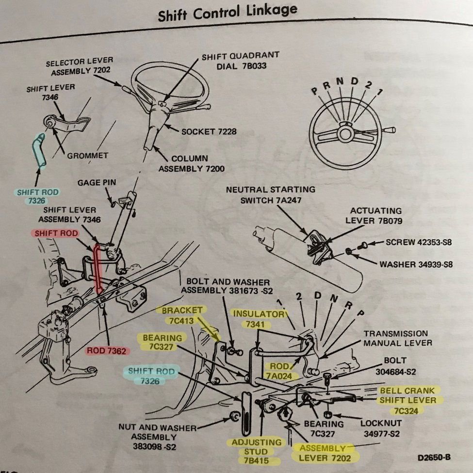

Is it parked on a steep slope by chance? If so hook it to another truck and pull it (just a very small bit) what ever direction to get the "slope pressure" off the trans parking pawls. Then try to shift it from the column. OR....With it still hooked to the other truck and some one on the brakes of BOTH (better idea) trucks. VERY CAREFULLY see if you can change the gears by hand/pliers on the (transmission manual lever) on the side of the trans, from under neath. 3 clicks from its present position is neutral.
DO NOT TRY any of this by yourself, like with it running and getting under there. GREAT WAY TO RUN YOURSELF OVER. BE SAFE, BE SMART. I would also....not trust the park brake to try this either. You might also want to:
1. Jack it up and see if the front wheels spin freely, to make sure the brakes are not froze up. Since it sat for so long.
2. If the fronts spin, I say no need to jack up the rear, remove the rear d/s and to the same ck on the rear wheels. But depends on how the fronts go.
3. Can you get under it (not running) and move the shift lever on the side of the trans by hand? Make sure to chalk block the rear wheels on BOTH sides. If it does go into neutral, it can roll.
Doing this ck by hand underneath takes out any question about the trans itself being bad. You can still have a steering column shift issue/broke parts.
A trans lever pic. https://www.ford-trucks.com/forums/1...l#post15688697
