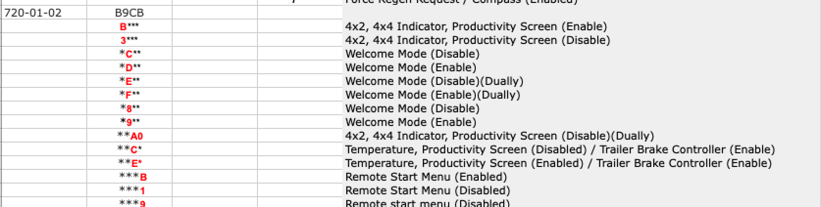

Make sure you have registered on the FORScan forum, your account has been approved by an admin and you have an extended license. You will need the Extended license to program keys and make changes to the as built data.
I added remote start to my 2011 F350. The local Ford dealer cut the keys that came with the remote start kit. My truck already 4 keys programmed and I only had 1 key that worked. so I deleted all the previous keys and programmed the 2 that I had. then enabled the remote start feature in the BCM and enabled the menu in the IPC. works very well.
In the BCM, modify line 726-19-01
in the IPC, modify line 720-01-02
