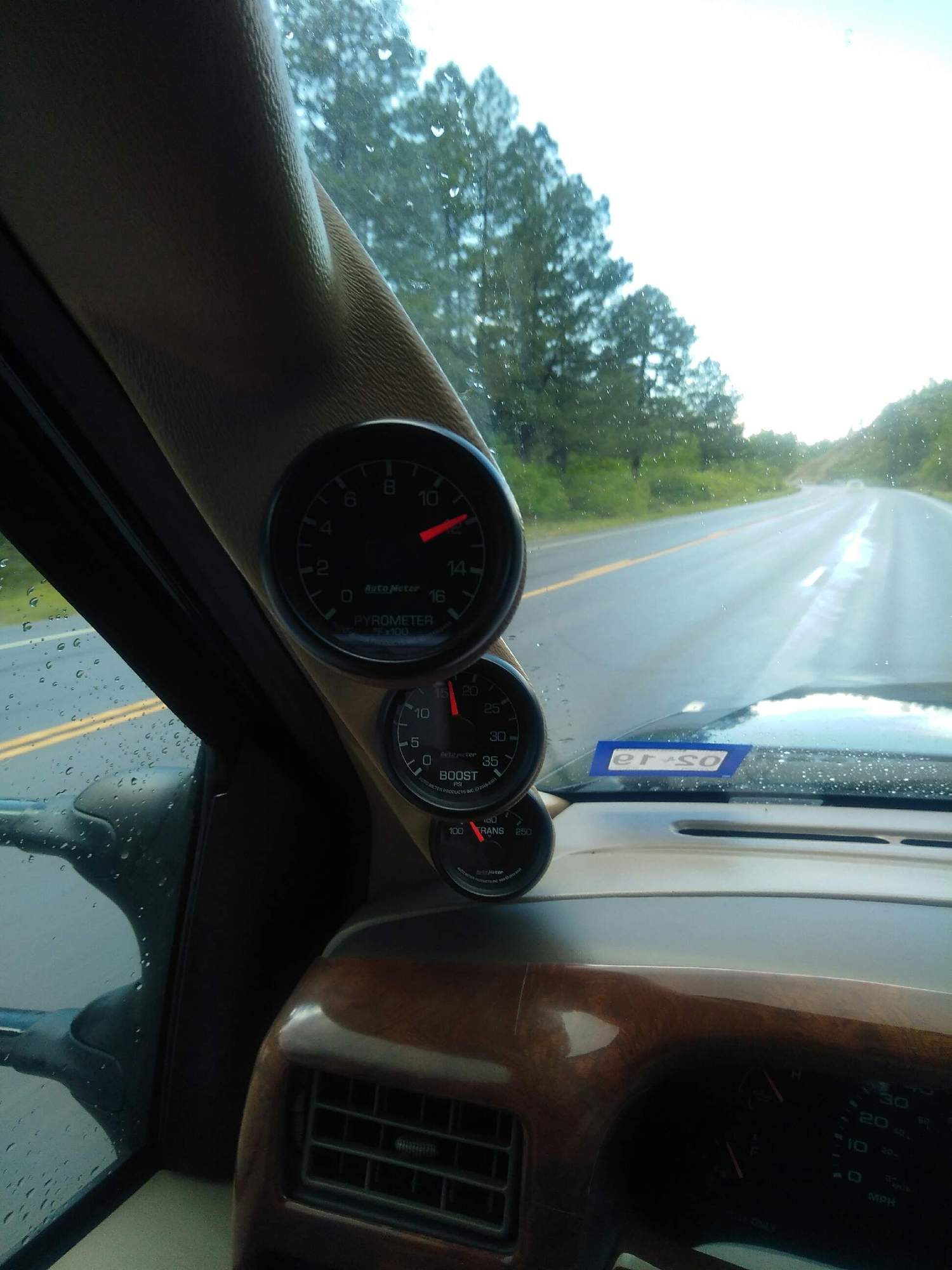

Thanks for all the responses so far. But what I meant before about backing out of the go peddle. I back out and I'm less than half peddle trying to pull a substantial hill and still maintining 1100. I know that if I hammer it to the floor it will go but I'm going to have a melt down of my pistons. It started last year in feb of 18 when I bought this 5th wheel. My truck didn't have a tuner. I had just put in the guages so I could see where things were at. When I pulled the 5th wheel home for the first time I was getting some high egts. And I talk to a friend of mine that works on busses and he gave a number to a diesel shop that he trusted. So I called that guy and he said I need a tuner. So I got one not that I didn't want to get one any way but it helped greese the wheels with my wife. I was thinking gears then but my friend doesn't think I'm going to see as much of a return as its going to cost to change the gears.
OK... now we have another piece of the puzzle that was missing before. In response to this particular post, we need to back up a bit and start troubleshooting instead of shotgunning.
I would yank the chip and do some logging with the "Big 10" on an OBDII app: MAP, EBP, FIPW, IPR, ICP, MPH, RPM, TC Slip, EOT, and TFT. You can't log EGTs, but you can make a mental note of the time during high EGTs for later documentation.

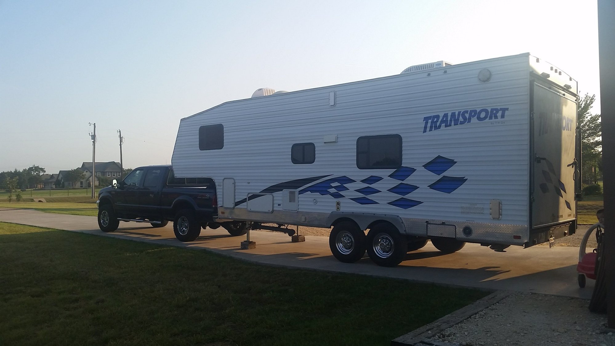

Onto tire size: I tow heavy in the mountains in the summertime, as timmyboy76 alluded:
I beefed my engine up a bit, and it has way more torque to pull (and accelerate) than a stocker. I have 3.73 gears, and I went from a stock 31" to a 33" tire. While my "race mode" improved with the bigger tires, my towing mode took a hit. I have hills that I have memorized every PID performance while towing heavy or towing nothing - and that measly 2" more diameter punished me under certain towing scenarios, but rewarded me in others. You're towing the limit of the stock truck, but you moved the line by putting non-stock tire size on the truck. If I were to tow that heavy on a stock engine with tuning, the "short" answer is I'd be shopping for altitudinally-challenged gears - or tires.
As for tuning, you went the opposite direction of lower EGTs - they're worse now. 1023 tuning does a respectable job. They do some weird stuff when they try to get fancy... like an "economy" tune, or a tractor pull tune - but the plain ol' elevated horsepower tune behaved quite nicely on Frankenstinky. The only caveat is the shift points sucked, but that's an easy thing to fix with a phone call.
If you don't mind going TS chip, Brian at BTS still rocks. This is the least expensive option (tuning-wise), and he knows a thing or two about how to treat your transmission while towing. If I didn't have Cody, Brian would tune for me - but I would have missed out on a great friendship.
I respectfully DISAGREE!
Stock injector truck, SXE turbo, 35 inch tires and 3.73 grades running 1023, PHP AND Cody tunes (all maxing out the stock injectors at roughly 65HP), I pull 6-7% grades in Colorado at 6-9K ft of elevation towing a 12K+ toy hauler with ease. 1150 degrees + or - . I have no problem accelerating from 50 MPH to 65 MPH up hills in third gear.
I do AGREE to PO's problem is running larger tires with his stock turbo though

I forgot to mention when I'm backing out of the throtle I am less than half peddle to keep egts down
With my setup, there is no such thing as backing out of the peddle unless I'm trying to stop from going to fast!

I dunno, if I have to back off the throttle in OD or 4th (usually not in 4th though) and drive by the EGT gauge, I don't really see it as a problem precisely and I am not racing anybody to the top of the hill. I like to tow slowly even on flat ground (60-65) and conserve fuel economy so maybe switching to 4.10's would not be a bad idea in my case. With 3.73's and 16" small 2wd DRW rubber effective final drive is already pretty low but it still lugs down in OD a bit lower than I like in the low 60's mph. ST chinabomb tires are only rated for 65 mph anyway
