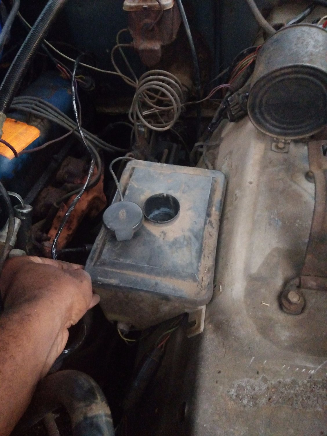

I noticed that this thing is not connected to anything other than the wires on the side. I'm just trying to to clean up my engine bay alittle. I was told this might be a overflow for my radiator. The radiator does have a small rubber hose going from the side and going nowhere. Just need a little help.

Windshield washer. Supposed to have a hose going to nozzles in the cowl.

Windshield washer reservior (spl?) … likely the motor burnt out or froze up with just water. You can get a new pump at auto store, then hook up hoses and have a windshield washer.

The motor in side does work( I press the windshield wiper button and heard it) I just need a small hose to connect. Thanks y'all can't figure this stuff out with out y'all.

I was told this might be a overflow for my radiator. The radiator does have a small rubber hose going from the side and going nowhere It certainly goes somewhere. The ground. Just need a little help.
Find a coolant overflow reservoir for the open end of that hose or the title of your next thread will be My Truck Is Overheating And I Don't Know Why. We get about 10 of those posted every year.
I use a one gallon anti-freeze plastic bottle and ran the hose to the bottom of it. After the engine cools it will suck the overflowed coolant back up.

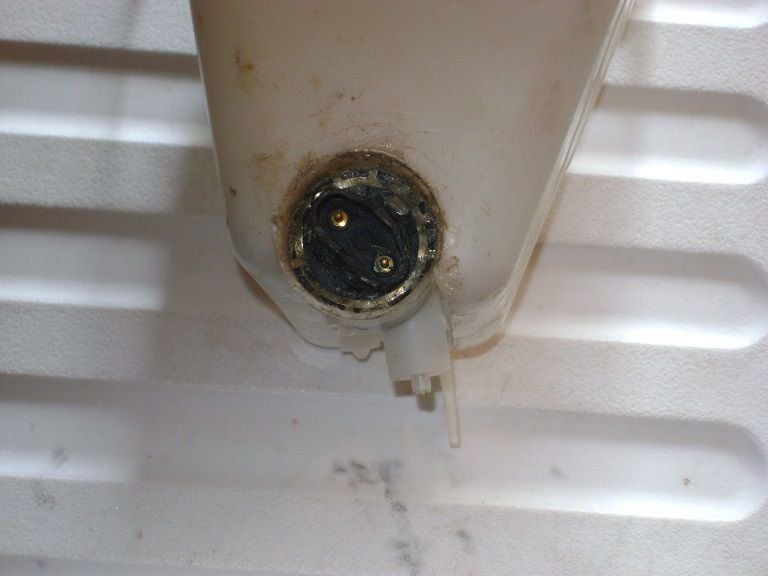

I have a cheap knock-off reservoir with motor that you can have for the cost of shipping. It was a poor copy and I ended up buying a good $38 one I think. The motor works but as you can see from the pics I tried to seal it with some sealer because it keep leaking and I finally gave up on it. I'm going to throw it in the trash so I'll offer it to you first.
