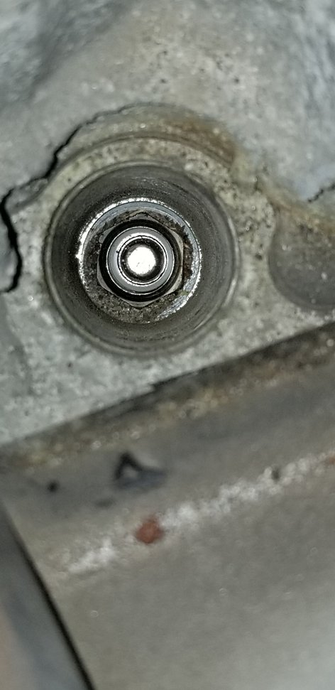

The last time this happened, I swapped out the OSS first and it did nothing. Then I replaced the coils and it fixed the issue. But then the issue came back. My thing is, if i replace these coils and it fixs it....how long will it stay fixed? Not sure i would have got a solid answer as to why. Ya know what i mean?

I know exactly what you mean. What I wonder is, did you use dielectric grease? Have you checked the condition of the spark plug holes? Water, dirt, anything?

When i replaced the plugs and coils last time i fabbed up a small funnel for my shopvac and cleaned out the holes prior to pulling the plugs. I will admit i did not use dielectric grease as I did not have any. Just checked the new coils and they came with some.

Yeah, but how do the holes look NOW?

They looked fine..........
Anybody need some probably bad maybe good coils? Lol
So I swapped out the coils and what do you know, she runs fine. Took it around the block a few times with zero issues. But for how long? Do i stick to the old adage of "keep it simple stupid" and write it off as bad coils? Do I spend the money on motorcraft coils? grrrrrrrr im still confused.
