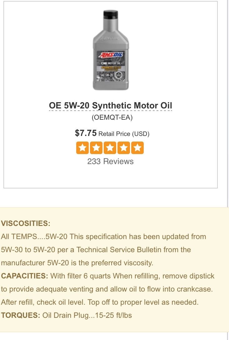

This is generally correct unless your manual doesn't mention extreme cold. If you live in a place where it's common to see negative degrees Fahrenheit, you likely need a thinner oil for the winter.
https://images.app.goo.gl/Fe7w1s8rhdMucf9q6
