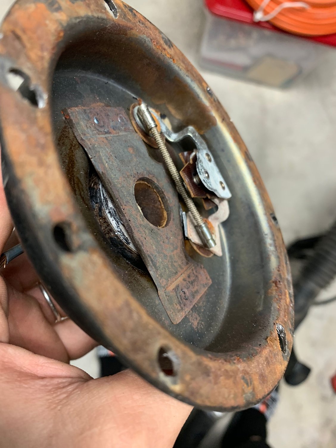

Hi guys, thanks for the replies. I’ll check Dennis Carpenter. But meanwhile, I just opened up the horn. Not too sure why I’m looking for? How do they look/ what should I do to it?

Could try using a fine point file carefully on the contacts.

Okay, what about the coil pack under the welded on plate. It was covered in black stuff that was loose and flakey
