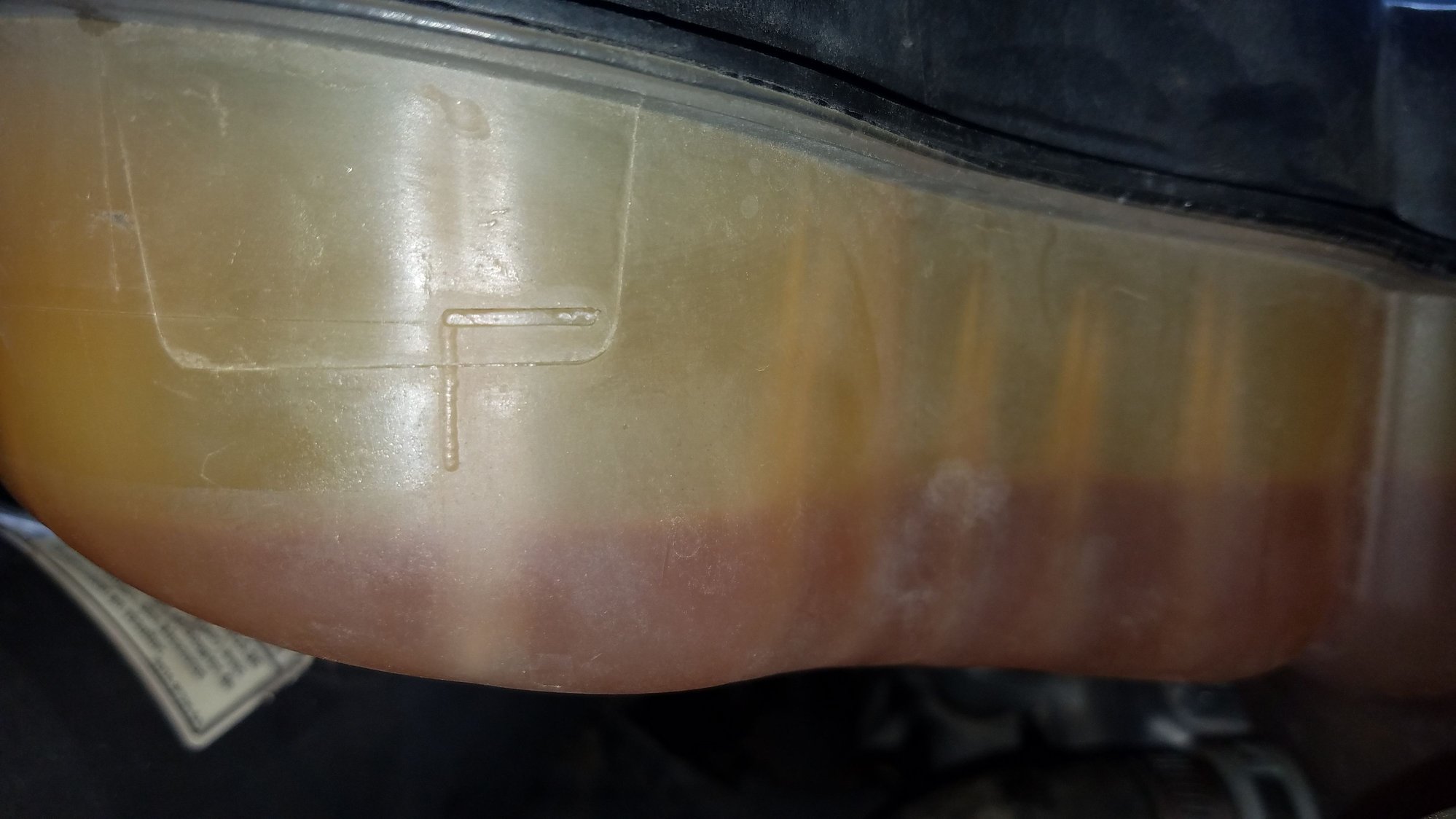

Here is a picture of level. This is after I took it down from cold upper level. I'm not exactly sure where it should be cold. Bottom of vertical line cold?

15 psi should hold for at least 4-5 hours, but leak free it should easily hold overnight.
Concentration just needs to be close to 50/50. A few percent either way isn't going to be an issue.
That looks like a decent cold fill level.
Basically if you fill the degas bottle too full, the pressure will go up. If the concentration is significantly weak, the pressure will go up. If you have a slight leak, the pressure may be falsely low. Sounds like you are ok. Personally I wouldn't be worrying assuming your system is relatively leak free.
