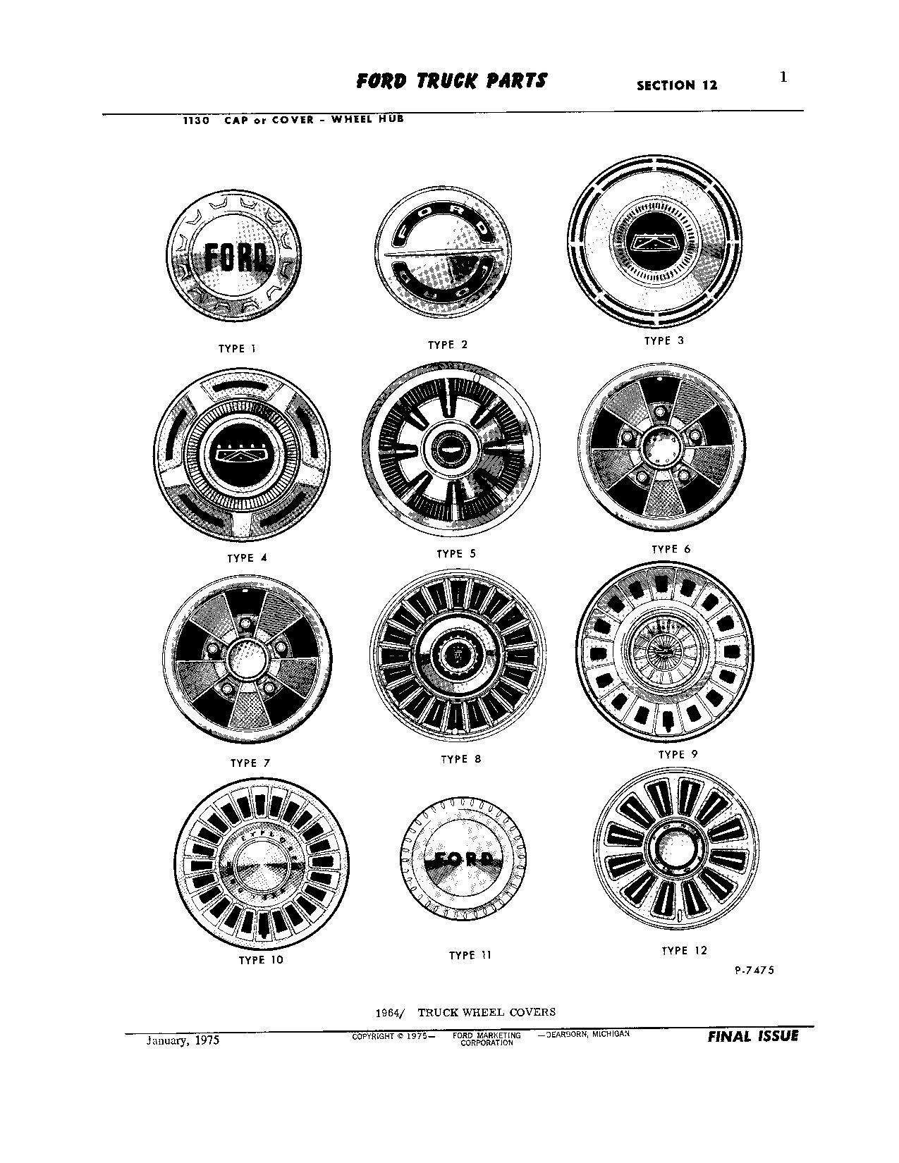

There were no front hubcaps with a hole in the center for the hub to poke thru available for F250 4WD's until the late 1980's.
However, some people take the 2WD hubcap, cut a hole in the center. See TYPE 4 in pic:
This is a 11 3/4" diameter "outie" hubcap used on 1967/77 F250/350 2WD and the rear wheels of F250 4WD's; 1969/74 E300; 1975/77 E250/350 / Both are obsolete.
Two versions: Painted argent with black appointments, or stainless steel with black appointments.
However you have to be careful when buying, because there are 1967/68 F250/350 "innie" versions that are 10 5/16" diameter.
"Innie" hubcaps will not fit "outie" wheels and vice versa.

Thanks for the info so far...just trying to source parts as the truck is still in Colorado and we are in Minnesota....so on the 390/360... can I use the 360 pan and dipstick on the 390?? and not to beat a dead horse...the rims on my 72 f250 are 16" split rims..which have good tires and we want to keep..we want to put the small caps on them … have seen a lot of 12" caps. will these work?
There's no 12" diameter cap, see post #3. Notice there's a difference between "innie" wheels/hubcaps and "outie" wheels/hubcaps.
Innie = So called because the hubcap snaps over tabs located on the inside of the wheels center section.
Outie = So called because the hubcap snaps over tabs located on the outside of the wheels center section.
1967/68's could be innies or outies, 1969 and later are outies, but one never knows...because people love to swap parts around.

F250's were not available with innie wheels after 1968. Outie wheels were introduced in 1967, so some 1967/68's have innies, some have outies, as do all 1969/96 F250's, 1997 F250 H/D's.
1967/68 innie wheels used a 10 5/16" diameter hubcap, 1967/77 F250 outie wheels used a 11 3/4" diameter hubcap.
OP has a 1971 F250 4WD that came with outie wheels and rear (only) outie hubcaps. See posts # 3 & 9.
And, the 390 was not factory installed with 4WD .. 1968/76 F100/250 4WD: Only available V8 = 360 2V
