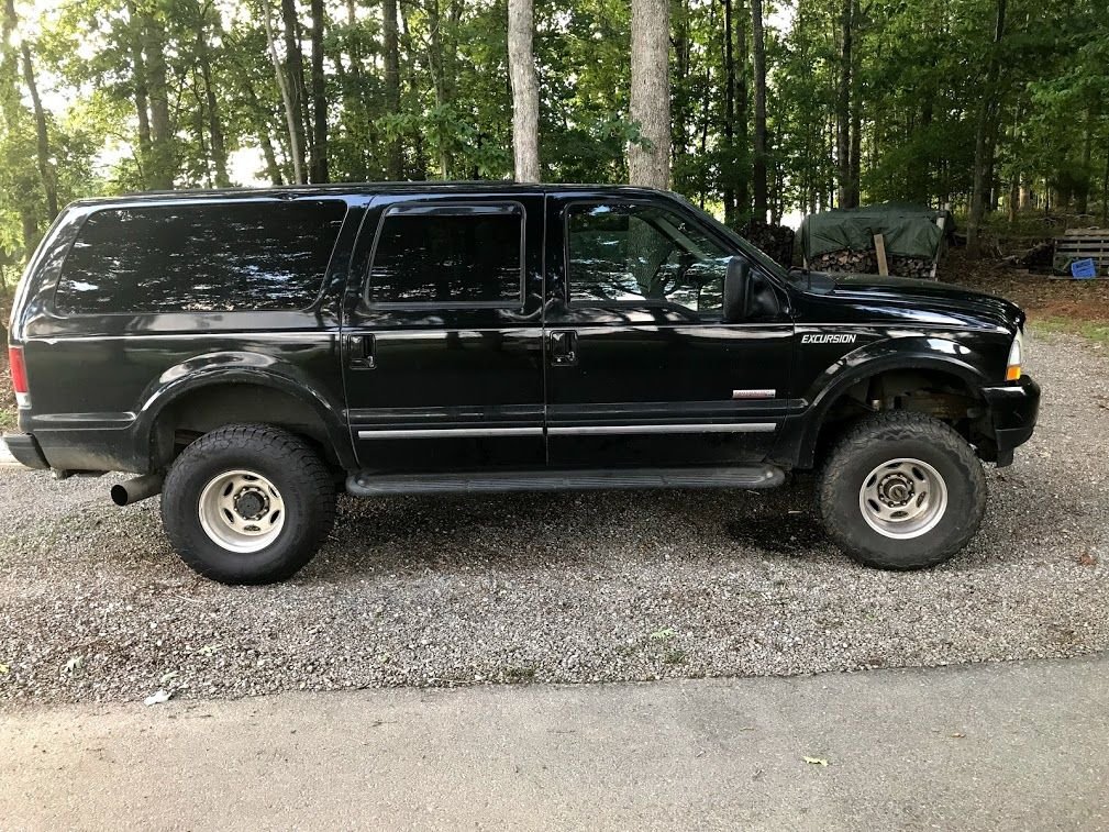

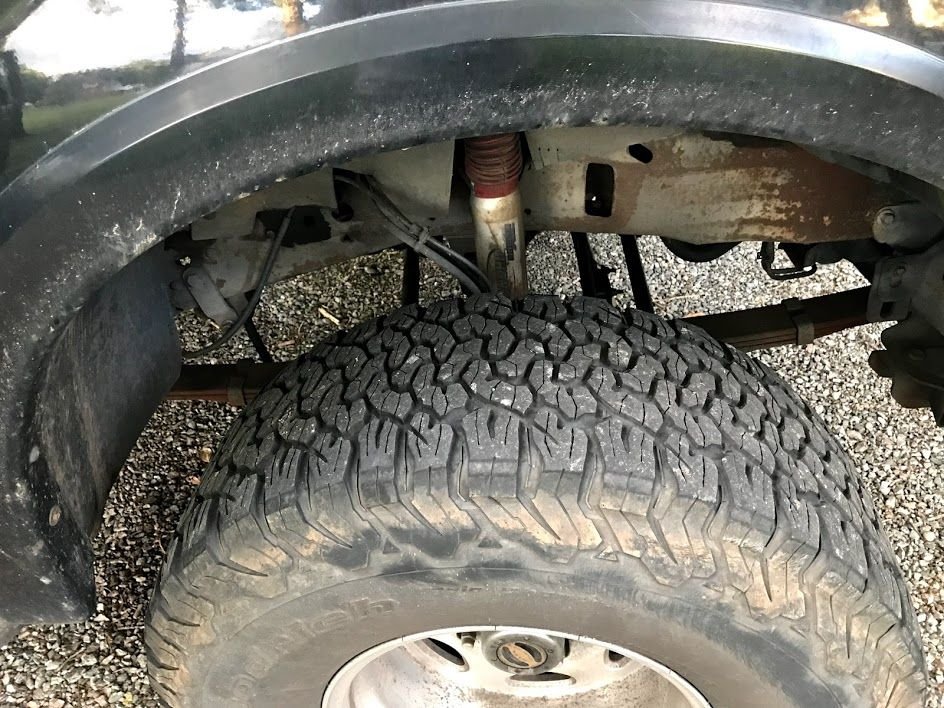

Pics of my Ex: (Yes that is a Nitto on the rear in the pic - had a cut tire and there were no BFGs in my size on the entire eastern seaboard - had to make do)
