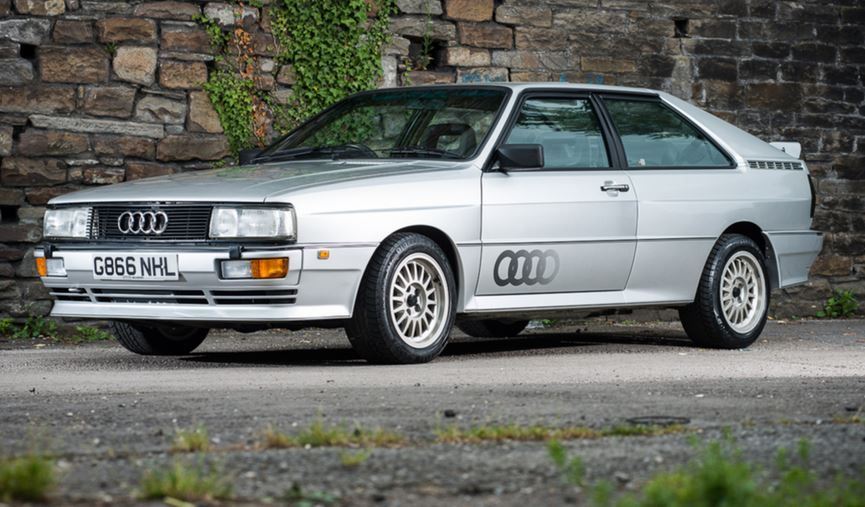

Old May 4, 2019 | 02:30 PM
Nighteyez's Avatar
Nighteyez
Active Streak: 30 Days
Posts: 21,071
Likes: 245
From: Fresno, CA.
Happy Quattro de Mayo.
