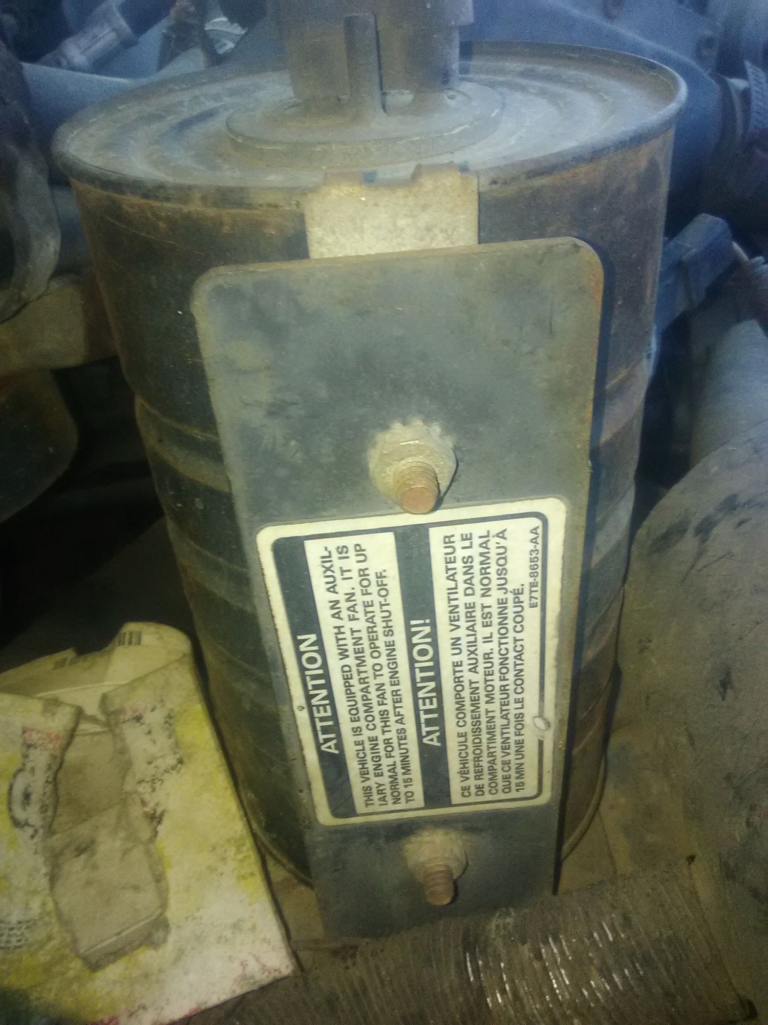

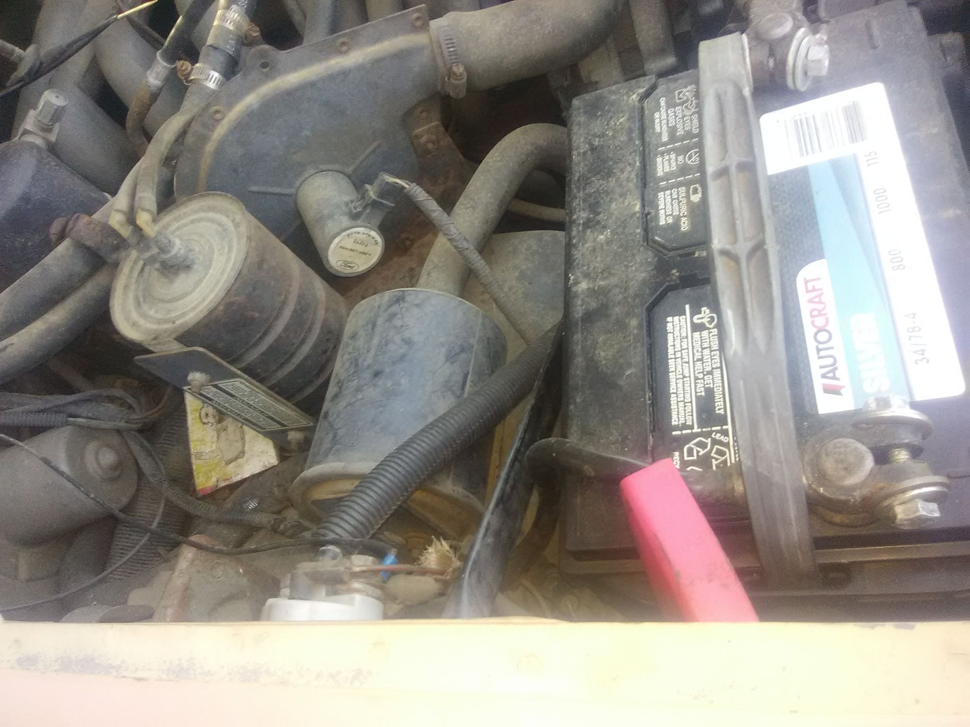

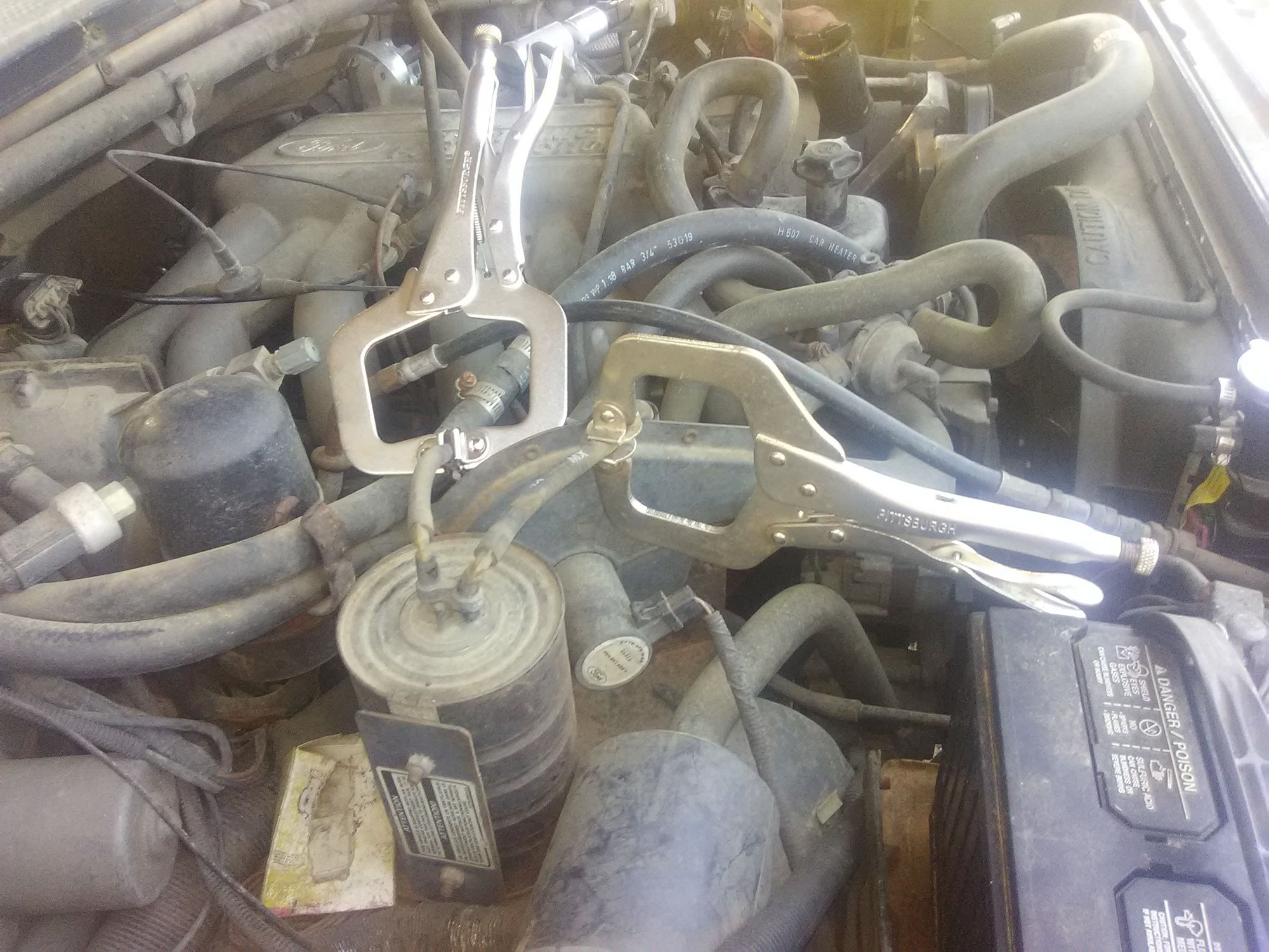

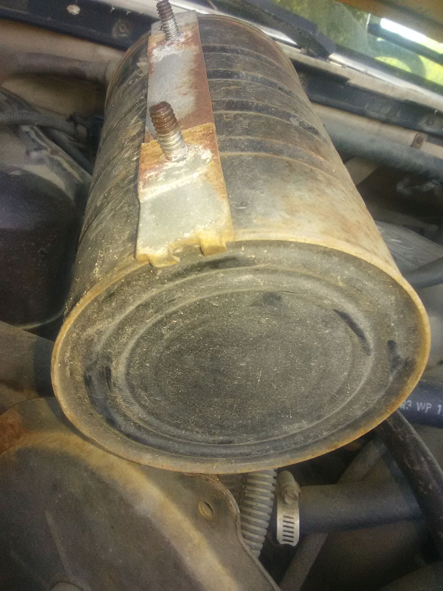

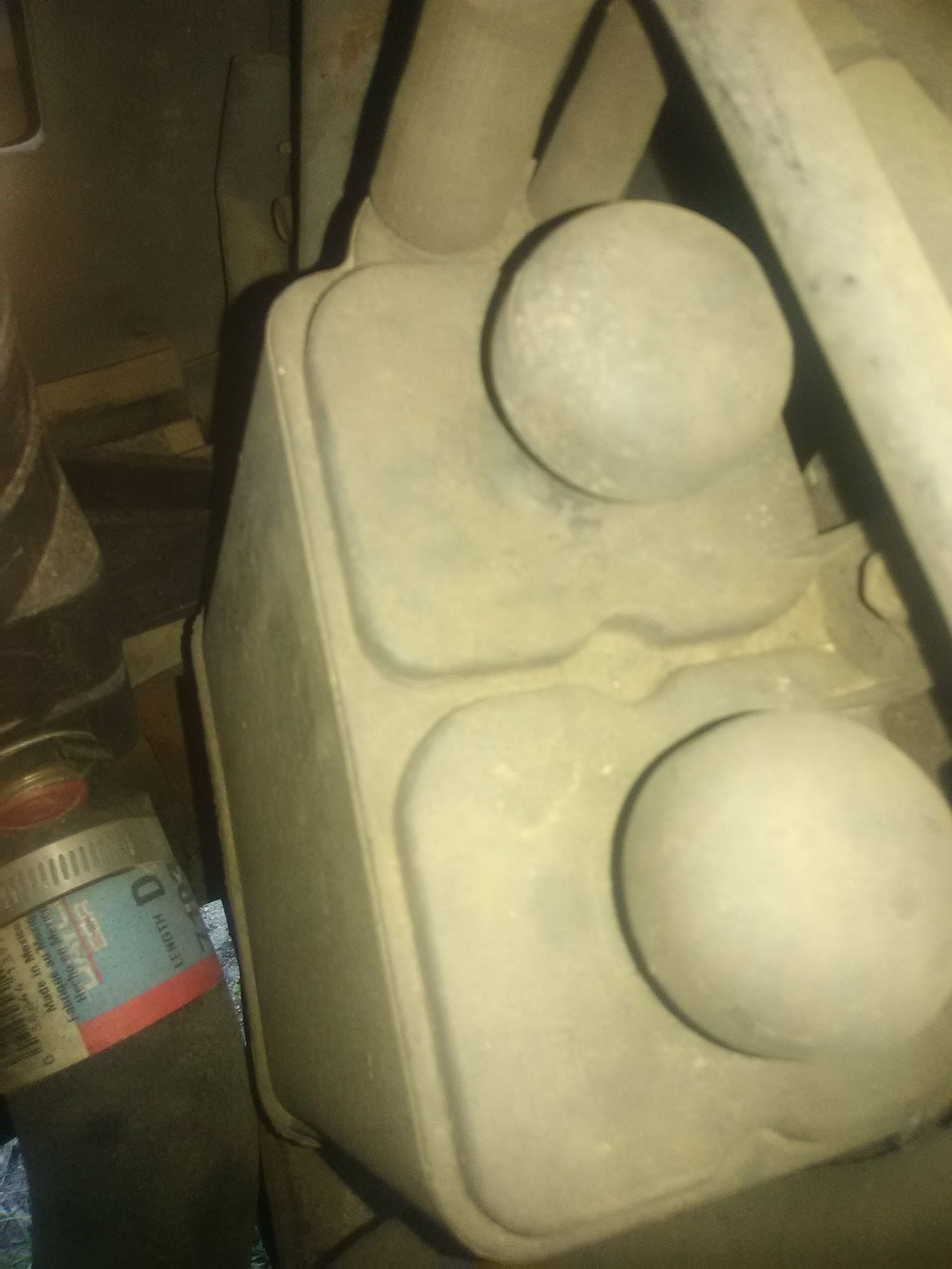

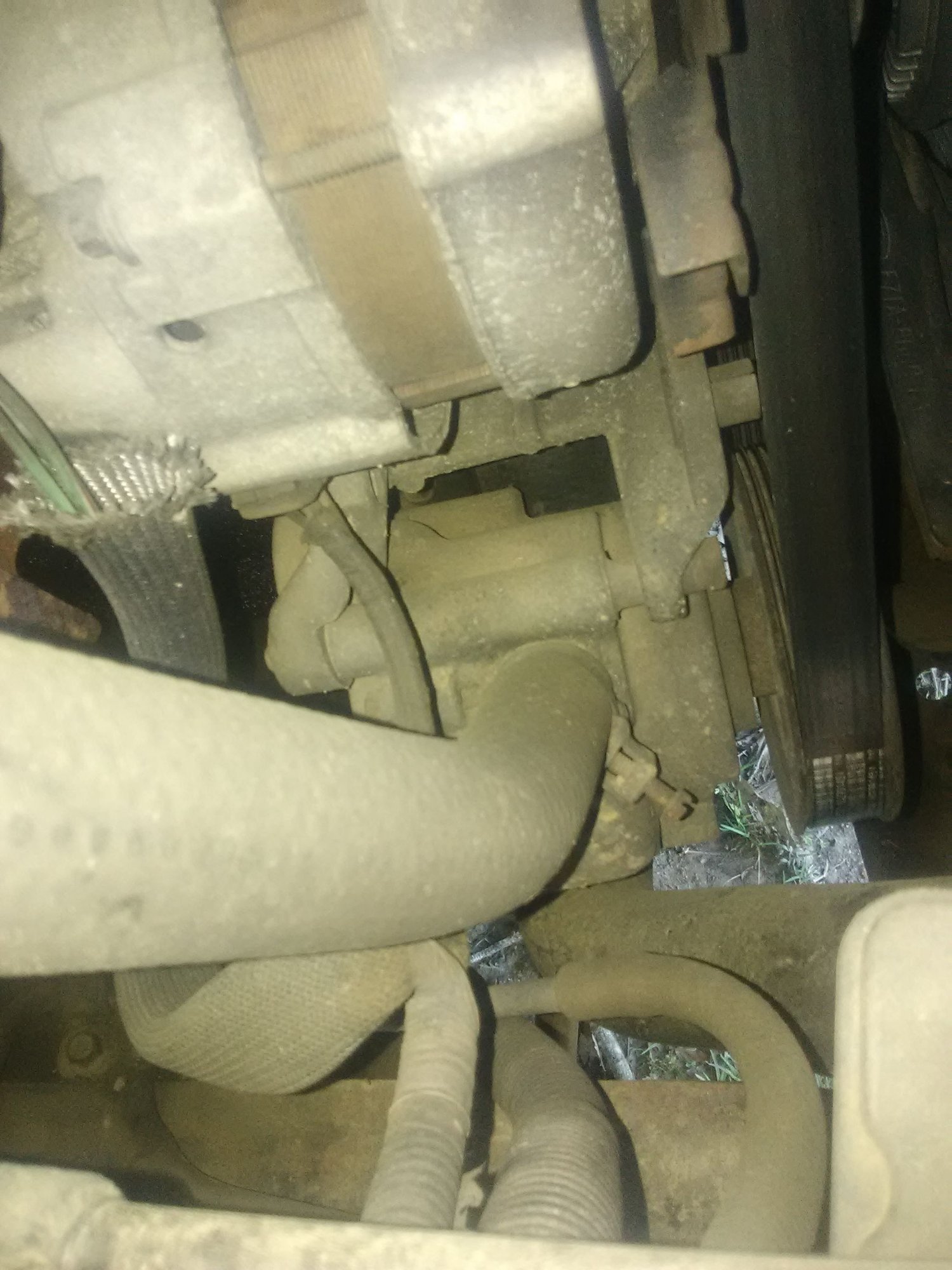

Three Canisters
Steel coffee can and cylindrical plastic/steel-lidded canisters.
Auxiliary engine compartment fan notice on steel coffee can mount.
Big hose running from cylindrical plastic/steel-lidded canister to air pump below alternator.
C-clamping coffee can canister's two vacuum lines lowered idle from ~2,000 RPM to...
~1,800 RPM.
Condition of steel lid of cylindrical plastic/steel-lidded canister.
Condition of bottom of coffee can canister.
No canisters are on driver's side.
Plastic rectangular canister mounted between battery and radiator's passenger-side tank.
Originally Posted by vjsimone View Post
yeah, look closed pretty well.
Something else to look over is the Vacuum Canisters, I don't know what styles you may have, but the Coffee Can style tends to rust out over the years and become a vacuum leak. The HVAC system sometimes has the round plastic Ball type.
If you photo the Fender Skirt area on both sides, we could determine what you have.
I see three what appear to me to be vacuum (or compressed air??) canisters. Those three are on the passenger side, no canisters are on the driver's side fender well and I see hide nor hair of any kind of "round plastic Ball type" canister.
There is an all-steel coffee can canister mounted on top of the passenger-side fender well to the rear of some kind of cylindrical plastic canister (with a cripped-on steel lid and a HUGE 1˝"-or-so-dia. hose going to the air pump mounted directly below the alternator). Also mounted between the battery and passenger-side radiator tank there is some kind of plastic rectangular canister with two rotatable round vent-like things on top and two vacuum hoses.
I unbolted the coffee can and cylindrical plastic/steel canisters, and they both appear to be in good shape, certainly not rusted through. However, I was able to C-clamp shut the two "rock hard" vacuum lines on the coffee can, and the idle went down from ~2,000 to ~1,800-1,900 RPM
See photos.
Don't worry about these two for now. You found the one I was speaking of with the 100 rpm leak in the lines.
