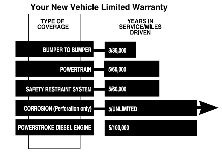

Just want to clarify the drivetrain/powertrain warranty on 11-16 trucks is 5 years or 60,000 miles whichever occurs first. The powerstroke diesel engine is covered for 5 years or 100,000 miles whichever occurs first. So when referring to drivetrain/powertrain we are talking about engine,transmission,transfer case, axles and driveshafts. I know you are looking for information regarding parts covered under the powerstroke diesel engine warranty so no big deal but didn't want somebody to read into the above and think the transmission was covered under warranty for 100,000 miles.
