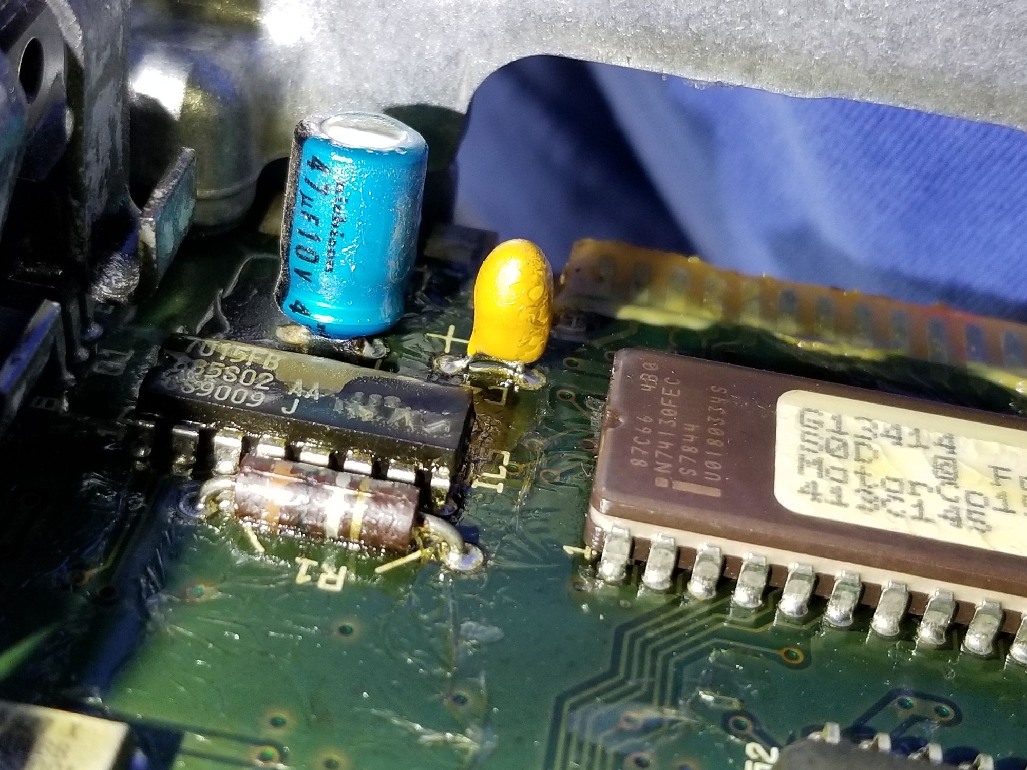

Looks like fluid leaked out on the right terminal
Dark spot under capacitor
I took the pcm out today, and this is what I found.

The 47uf 10V cap also has a buldging top which is another sign it is bad. Replace all of them even though the others look good. The yellow one "C4" is a tantulum Cap they don't leak but they will pop and burn. Your call but I would replace them all.

I ended up buying a remanufactured one from carid.com. It was $117 with the $50 core charge. I don't think that's a bad price. I wanted to just change out the capacitor, but it seems the part under it might have been affected also. It should be here by the end of the week. I'll check back in when I install it.
