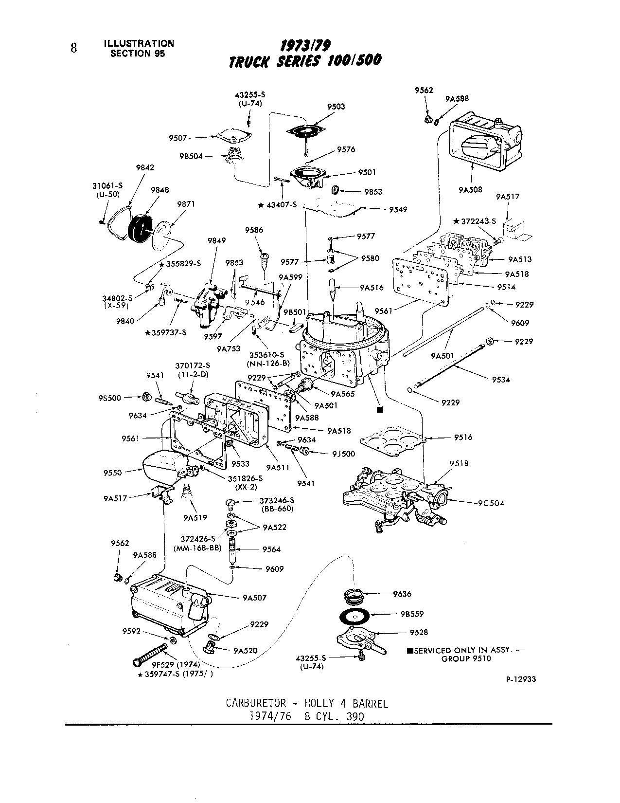

OP said that, but...there's no such thing! So one has to wonder what the 4V is actually from.
All 1973/79 F100/350's have an automatic choke, doesn't make any difference if it's an I-6 or V8.
1974/76 F100/350 390 available with a Holley 4V
Here's a pic of the little darlin'

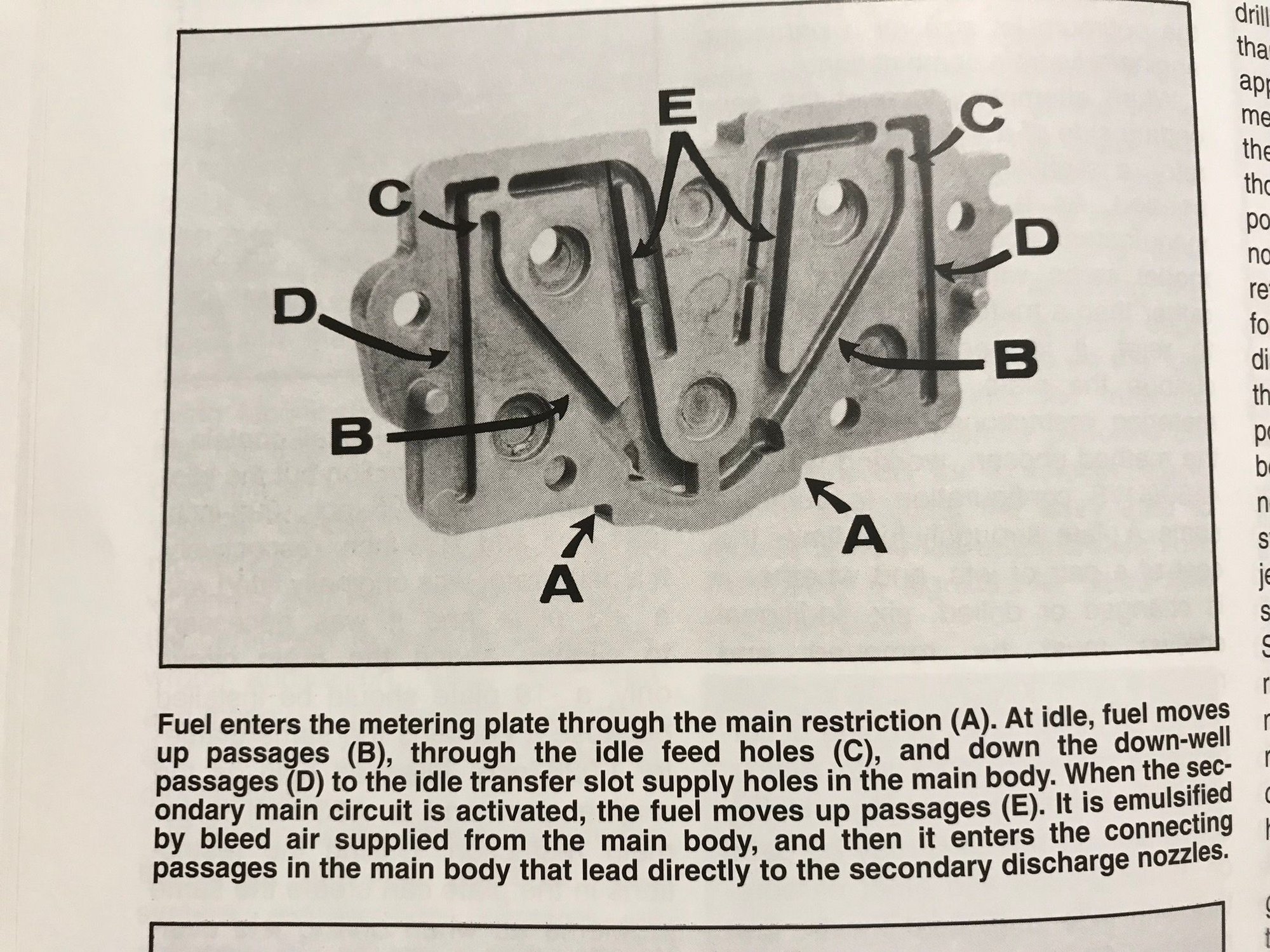

Secondary throttle plate workings.

Good info, thanks Hetz!
When I did an image search of the p/n, all I saw was electric chokes on them as well. I chalked it up to 1 of 3 things:
1. Google showing me random carburetors
2. It's already been converted
3. The OP misspoke
We'll need some confirmation on what's actually going on with that as well!

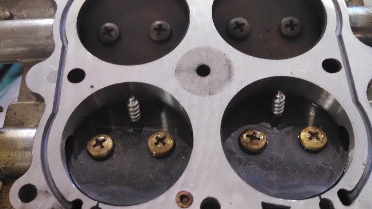

Just don't be like this guy:
Pair of 600 Holley's I worked on(repaired) for a guy. Things that make you go "Hmmmm".
Note the heads of the screws are on the BOTTOM side of the baseplate. Yes, if they got loose, they would get eaten.
Some people should not be allowed around tools.
Once I got them both back to stock and adjusted properly, they ran like a Timex. Too many hacks don't help. It was a very mild 427 MR with 2x4's. You couldn't stand within 20ft of it at first it chugged fuel so bad. Now it's fine.
