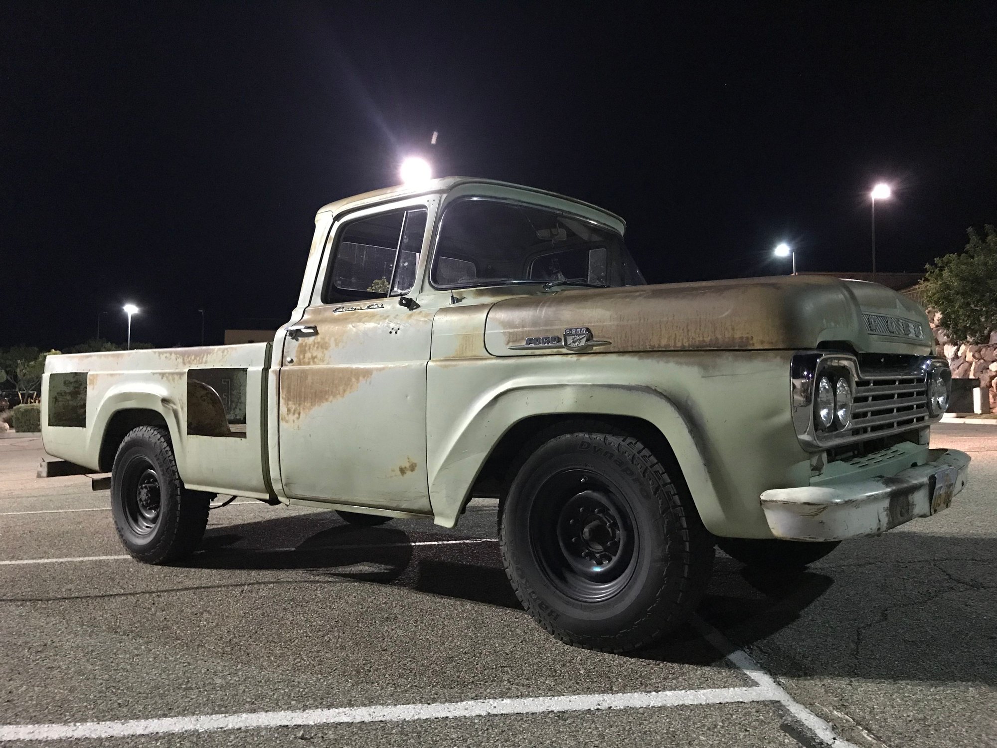

Here she is, just as I bought her
I just bought my project truck, 62 F100, 292 yblock, looks to be stock to me. Admittedly, I would not really be able to tell. I believe I have the 2bl unit now.
How do I go about upgrading my carb to a higher performance unit? I'm not interested in keeping it completely stock, so I don't really want to upgrade with the 4bbl that was an option for the yblocks. I have manual choke right now of course, but could be persuaded to go with electric choke. I''ve read that it's not difficult to install. I'm not going to drag this truck, but I do want to significantly increase the tire burning, red light racing fun!
  • What throttle body do I need?
  • What Carb will fit my application?
FYI, I'm handy with a wrench, but in no way a mechanic, so a lot of the posts are over my head (as of right now, hopefully that will change as I keep working on my yblock). I have a long way to go, so any other general helpful tips are appreciated.

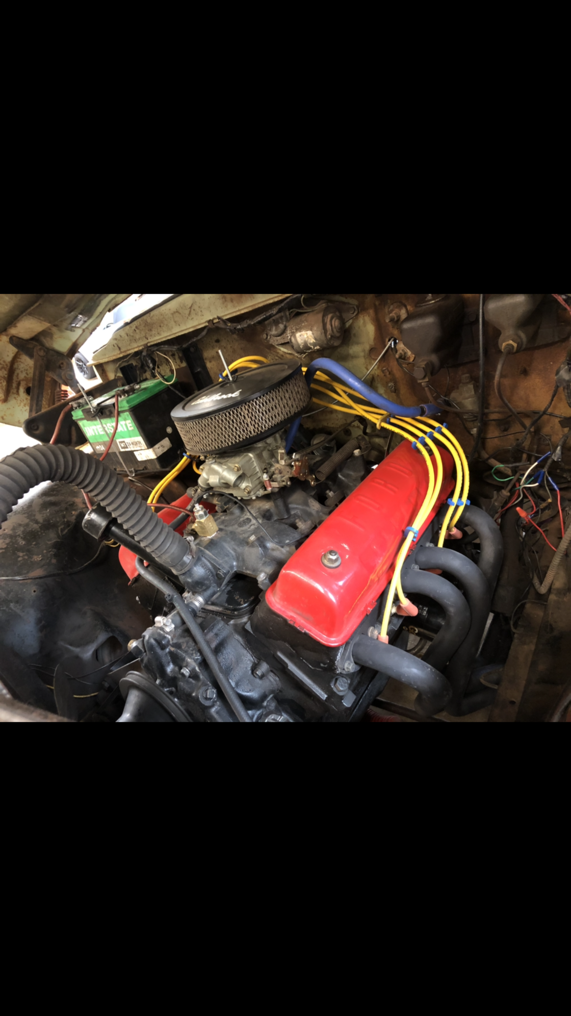

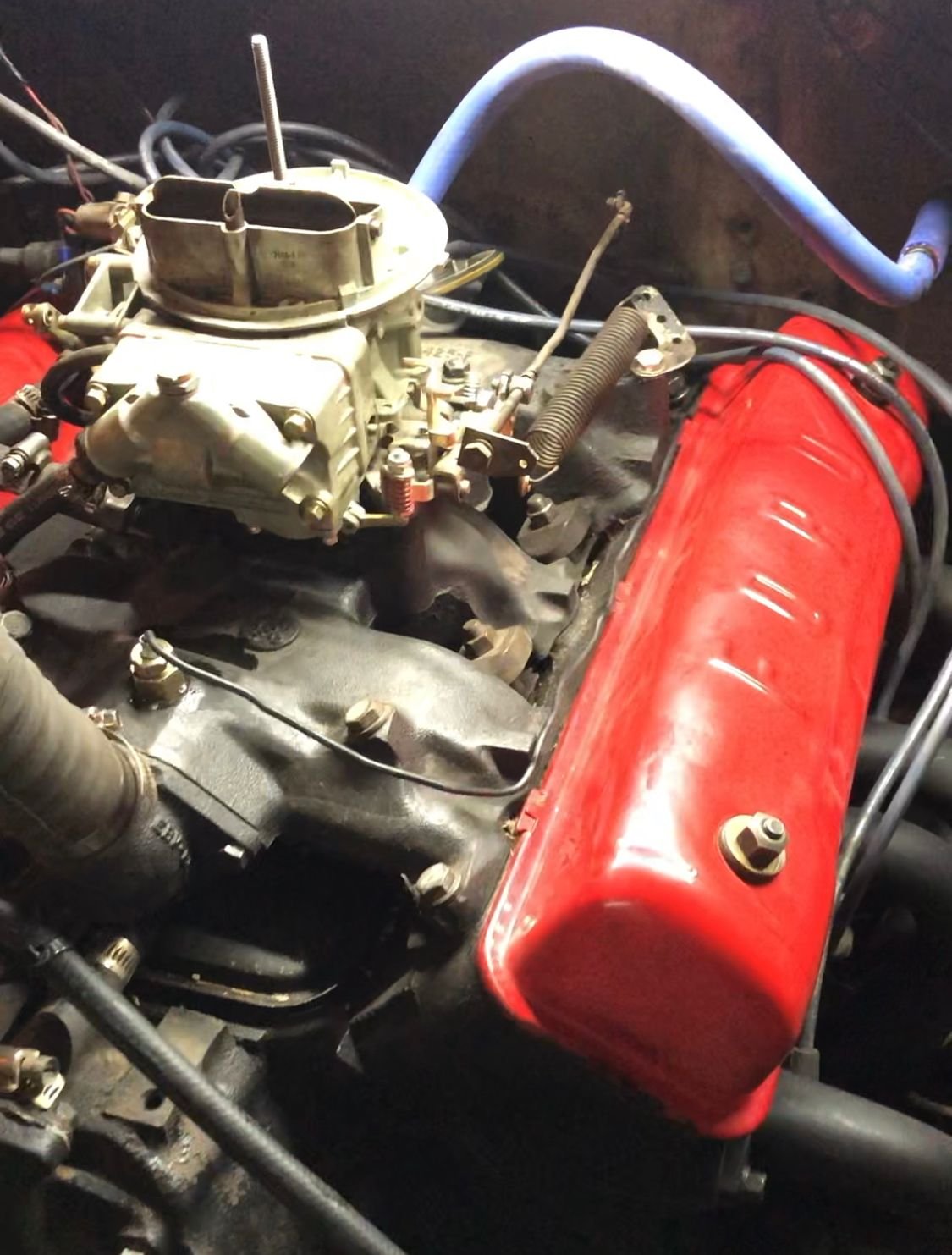

Ive got a Holley 0-7448 on my ‘59 F250. It just depends on the kind of power you want. I’m almost 300 hp On my truck. And most people say you need a 4bbl if your going to do anything to your engine. But a 2bbl can still pack a punch, and it shocks all the car guys who see it’s only a 2bbl. And you don’t have to change your intake either as an added bonus
Old Sep 12, 2019 | 10:19 AM
Tedster9's Avatar
Tedster9
Joined: Apr 2002
Posts: 19,311
Likes: 97
From: Waterloo, Iowa
That's a 350 CFM 2bbl carburetor, that is right in thar for a performance "sweet spot". Carburetor selection is the most important "adjustment" of all and it is usually misunderstood, people buy something based on appearance or think bigger is always better, or buy something unsuitable for simply driving around and cruising. If a carburetor is sized too big, it will actually run lean.
