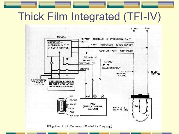

I'm going to assume the distributor module tells the ecm that the engine is spinning?
  #60
Old 04-20-2019, 03:05 PM
vjsimone's Avatar
vjsimone
vjsimone is offline
Old-Timer
Join Date: Jun 2013
Location: Somewhere n North America
Posts: 3,078
vjsimone has a good reputation on FTE.vjsimone has a good reputation on FTE.
Yes, the Hall-Effect device reacts to the turning of the vane in the Distributor, that signal is applied to the TFI module mounted to the Distributor and the TFI module sends the signal to the ECA/Computer.
