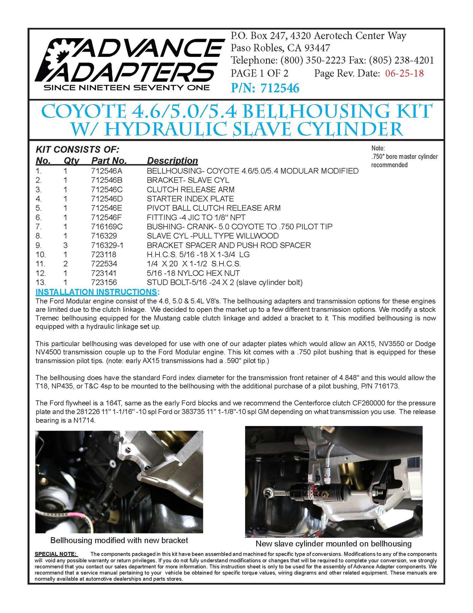

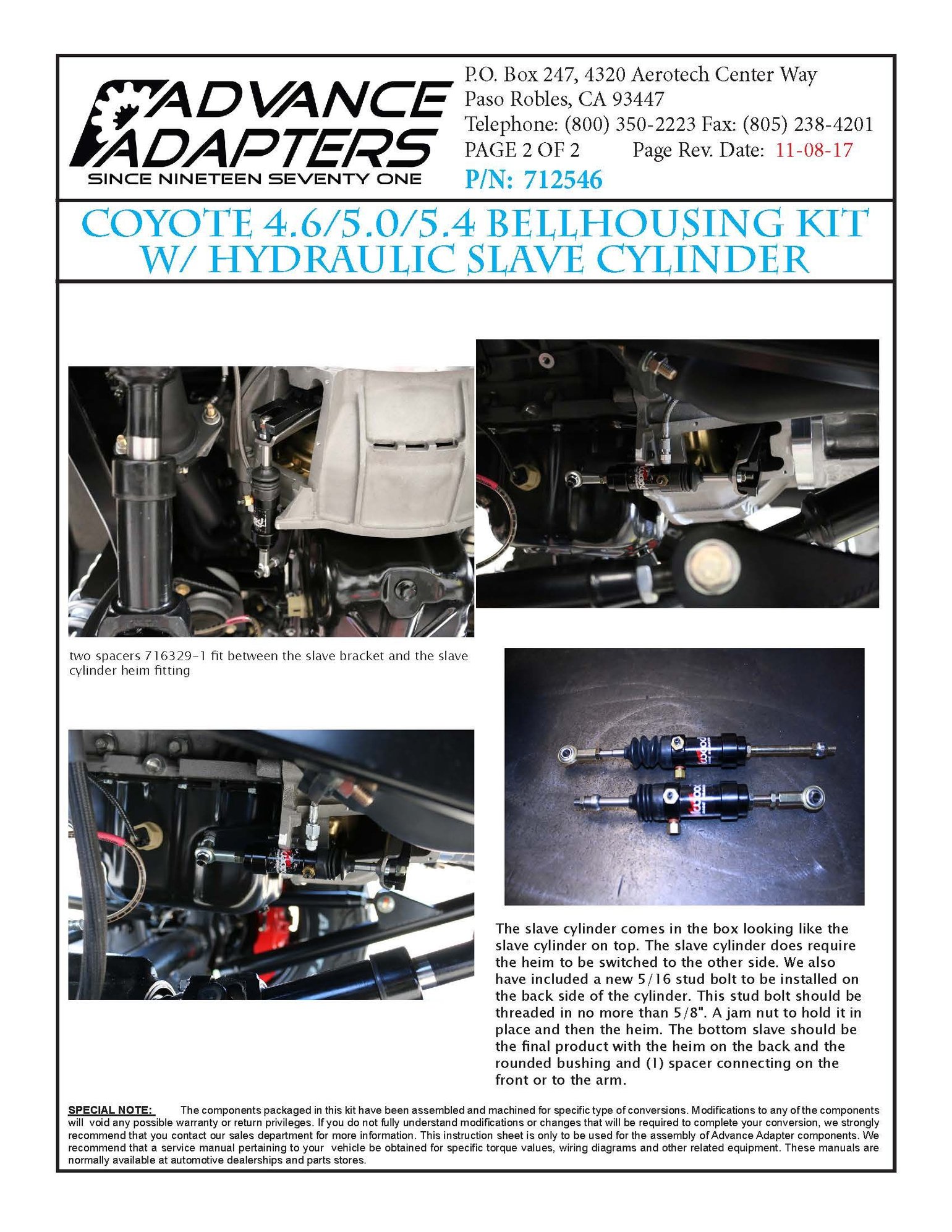

Originally Posted by Korbin View Post
The 4.6 is out of a 2009 crown Vic police interceptor. Only trying to see if it’s possible cause that’s what I already have
Complete package bell housing.
Not cheap but has everything needed.
https://www.advanceadapters.com/prod...t-w-hydraulic/
https://www.advanceadapters.com/prod...-id-x-1377-od/
