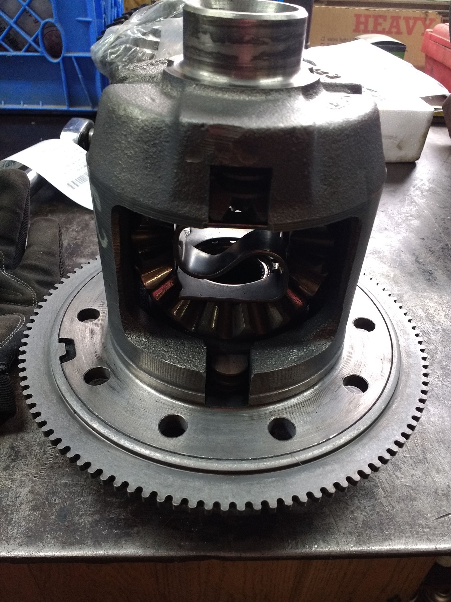

limited slip. Now this is just a u-pull unit from an explorer. Explorers are 31spline axles like full size trucks. I had planned on an 8.8 build for the falcon I had but never happened. Now we have 2 tires turning
drained and checking back lash before removal.
Fluid was fairly newish looking. Seems to have been serviced at some point.

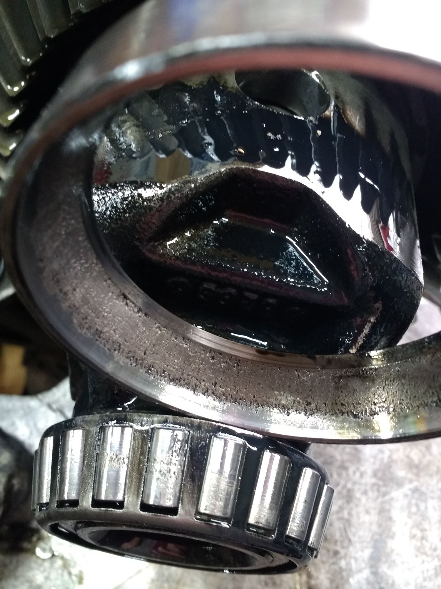

Guess my being goofy was good. One of the old carrier bearings was on it's way out. Never had any noise or indication I needed to do anything.
New carrier of course got a fresh pair of bearings either way.
