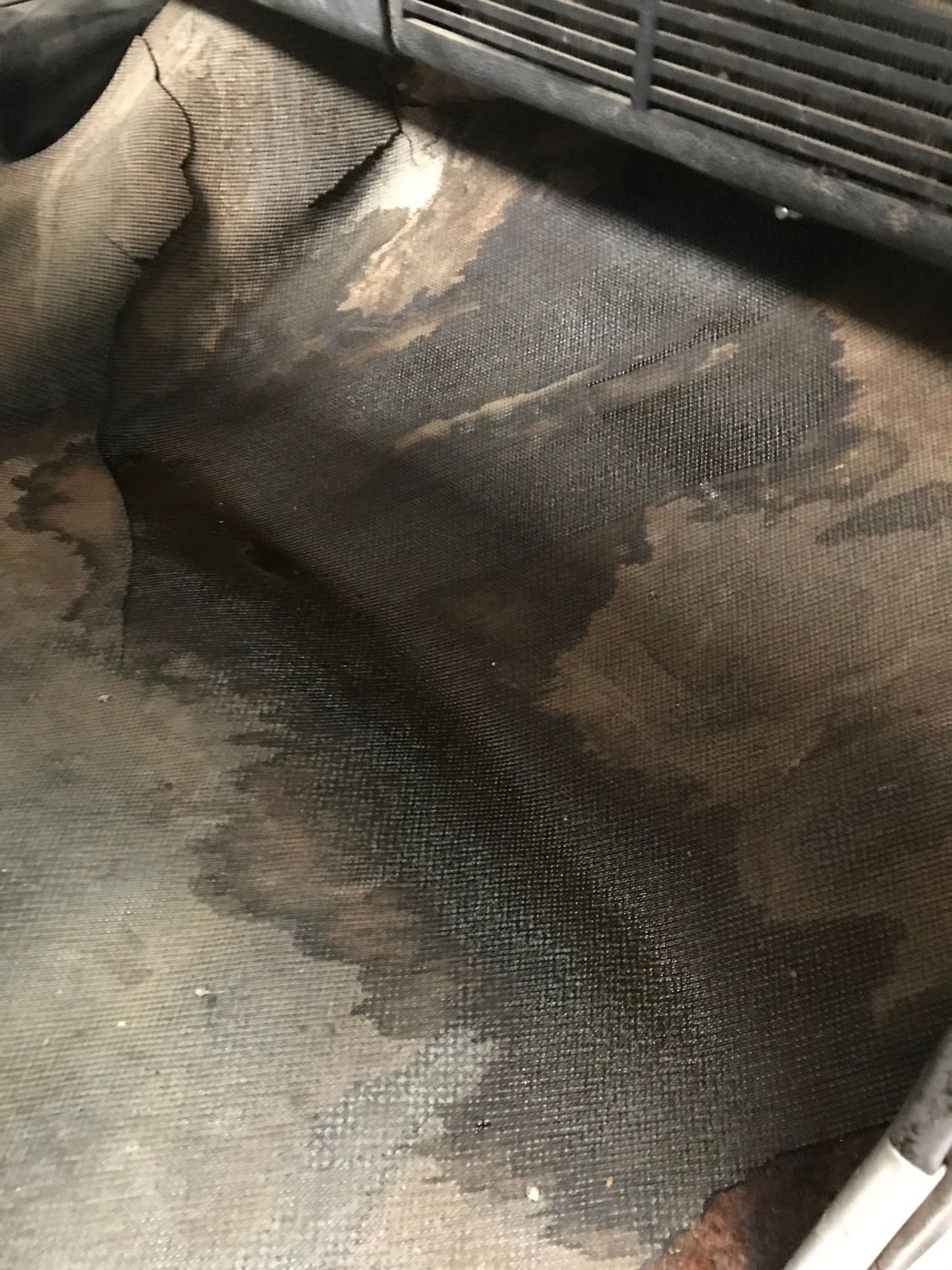

I'm trying to remove my AC system as it's leaking fluid on my floorboard and I want to get that fixed prior to fixing the rust in the floor board. See radiator fluid on the floor board in the pic.

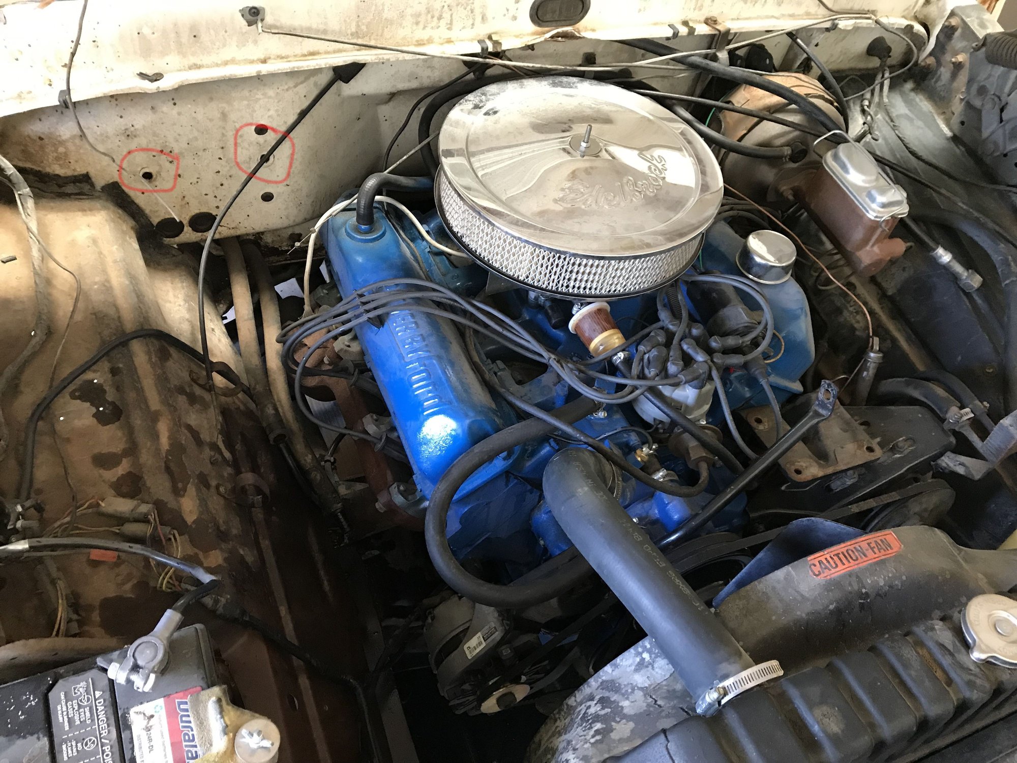

Any suggestions on how to get this big ole box out from the cab? I've got the hoses undone and the compressor removed, but I'm not sure what other bolts I need to removed. I've circled two bolts that I've removed in the engine bay as I figured out those were holding the system up.
I've also removed the circled bolts from in the cab, but I'm not sure if there are any further bolts holding the AC system/box in place.

If it's anti-freeze, there was no need to remove the compressor or lines. 99.9% chance the inlet or outlet tubes in the heater core are leaking. Been there/done that to many times. It's basically a feel all around to locate the screws holding the front case (18754?) on. Air inlet (18A586) needs to be un-clamped. Glove box in the dash and glove box door need to be removed to access the top of the front case. I wanna say 19C853 & 18C855 brackets need to come off as well. It's been to many years since I had mine out...

I used to have a cab with that unit. Remove the glovebox liner(very shallow version) and make sure all brackets/bolts are off. I can't recall all the mounting points. "IF" you want, you can replace the heater core in that original model. You have to completely dismantle it from the front to get to the core in the back. As me, I know. You would think they would put an access panel in the back? Nope.
