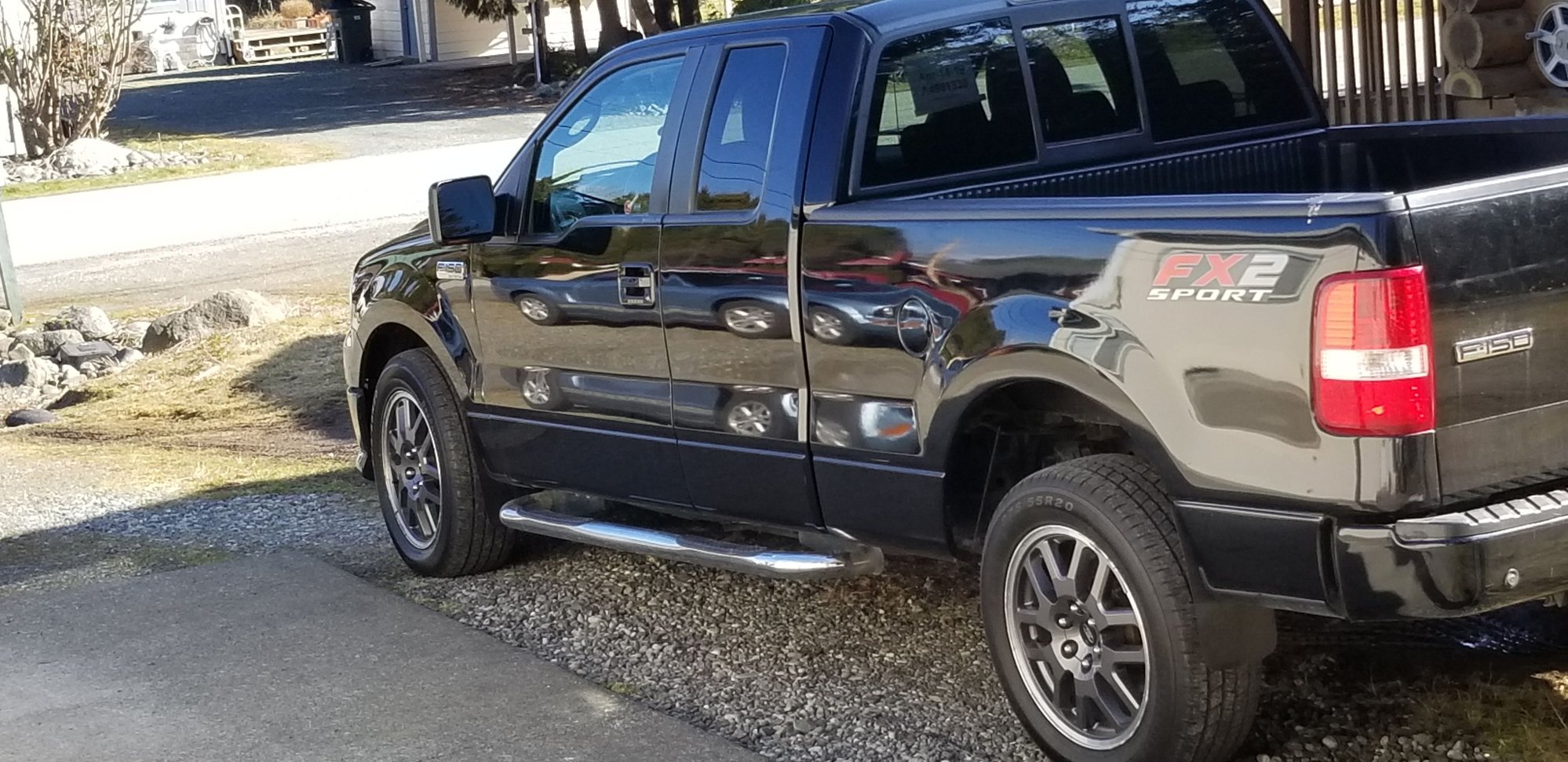

I just bought an 2008 F150 5.4 liter with about 81000 mi on it, it has a fresh dealer oil change of Castrol 5w-20 full synthetic, I've been reading some stories about the timing chain tensioners and maybe switching to 5w-30 or maybe some high mileage oil, any one else tried this?

Yep! Didn’t ever want to believe the hype about doing this but yeah my timing chain got all stretched out and the guides broke on me. I still drove it for days like that. Just couldn’t get past 35mph though. So I know your manual states 5w20. And I know your oil cap says this too. I ran 5w20 in it for a year at 98,000 miles. I’d never do it again. Just trust me on this, I just went through a rebuild. 5w30 from now on. These Triton’s need it. I didn’t want to believe it but it silenced the truck. Get yourself a cheap Melling high pressure oil pump. Don’t forget about getting a tune up. Make sure spark plugs and coils are good to go. You’re coming close to that VCT solenoid change time too. You can pick up two Ford ones for about 140. Should be pretty safe after all that. Sweet looking Triton btw. Those FX’s are sweet.
