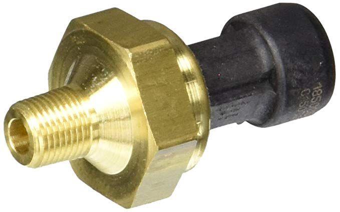

Many people have had issues w/ aftermarket ICP sensors. Some right out of the box. The 04.5 and up ICP (OEM) sensors are very reliable. The way to tell if it is good or bad is to look at the ICP voltage along with the pressure reading.
