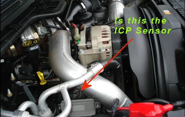

Is this the ICP sensor?
THIS IS my truck. Is that the sensor in this picture?

Correct, that is your ICP sensor, you have a later build 04
