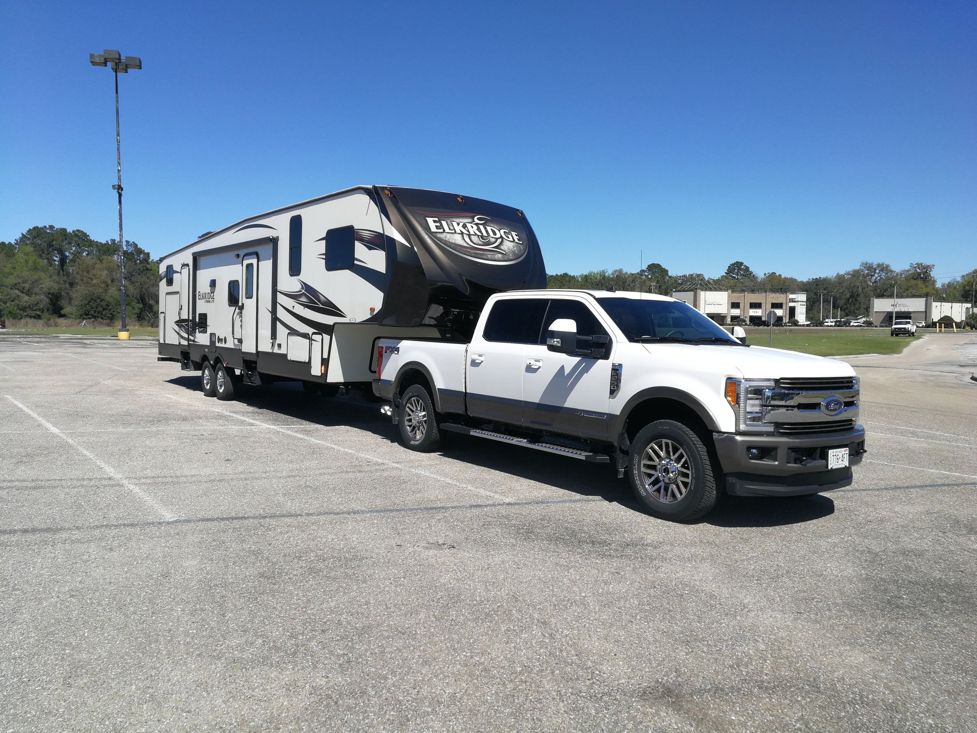

It is a 39.5' heartland, weighs 12000 loaded with 2000 or so of that on the pin. All tires are at 80 psi.

The trailer is level to a tad high at the front, very close to level. All the heavy stuff is middle to upfront. Trailer is in perfect shape. The ram had the five link rear suspension with coil springs. I will say it was a stiffer ride.

Yes, it is an extreme light model, that is all it weighs, it is at just under 20 000 gross combined. (truck and trailer)
