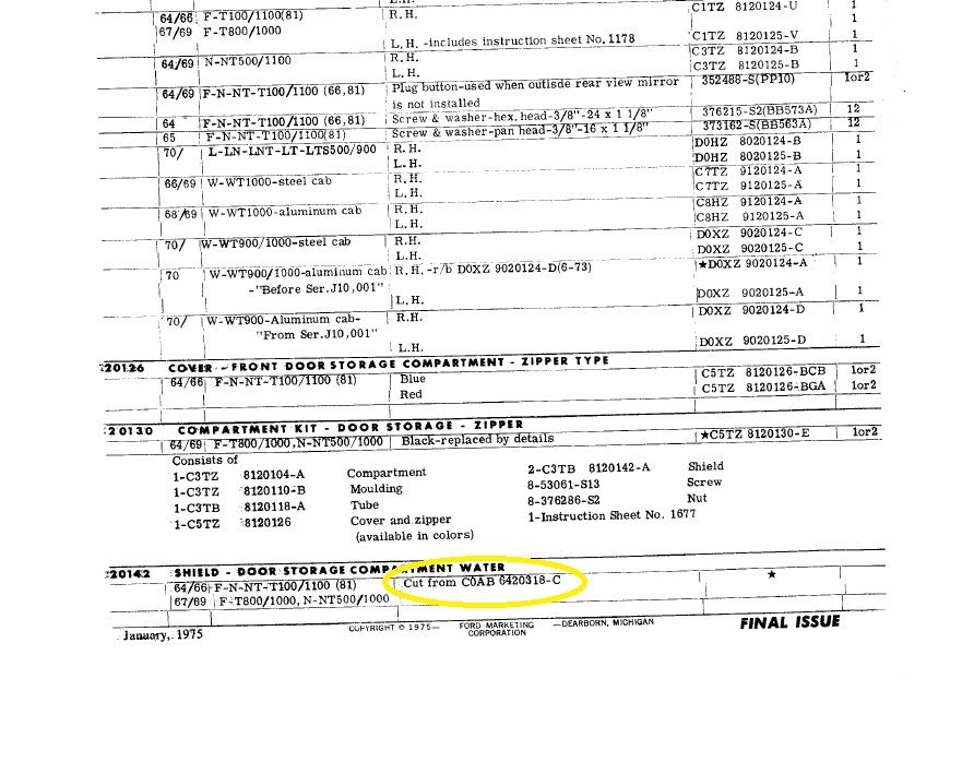

Where is 20318 in the truck catalog? ebay ad says "full sized Fords," it's listed in the 1965/72 Ford car parts catalog for all 1965/70 cars & 1966/70 Bronco. 28" x 54" cut to fit.

Where did you find 20318?
Go up one to page 3 at the bottom under 20142. It's actually listed in two places so also Section 200 page 29 under 237A04
Chad

page 3 = cut from...
Yep, that's it. "Cut from" on that page and "Cut to fit from" under 237A04 on page 29. Same item, just listed twice since, I guess, some have just the sheet metal panel and some have the zippered pocket so it is handy to look up for either case.

For those without the MPC here's portions on those two pages with the replacement part number circled on both
Section 200 page 3
Section 200 page 29
Chad
