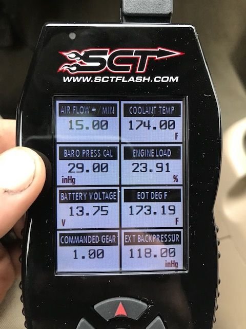

Today i went and looked at a 2005 F350 king ranch with 137000 miles on it that just came available at a local BMW dealership. They are asking $16995 for it. The truck has had the egr deleted and straight piped. The dealership had a local diesel shop come out and instal a tuner to get rid of the check engine light.
When i got there today one of the new salesman went to pull the truck around for me to take it for a test drive and I followed him to witness the cold start. He did not allow the glow plugs to heat up and tried to start the truck right as he got in it. After the second time trying to start it, it cranked up and shot out a puff of white smoke then black smoke then it cleared. After he pulled it around I had him turn it off while I waited on my salesman to come out so we could take it on a test drive. When I started it back up there was no smoke and it started just fine. After the test drive we came back and hooked up a scan tool to look at the EOT and ECT which are in the pictures. The truck drove great, we did a little city driving and then got on a hwy and cruised at 70 for a couple miles.

Exhaust back pressure is really high like mine. Best I can tell anyway from searching the archives.

Suspiciously low miles for that many owners. To find one owner that only put that many miles on their truck what do you need but to find five of them that all on the same truck is crazy ridiculous. I would check the hour meter on it first and see if that matches up those miles. Checking the Delta on your oil and coolant has to be done while you're driving not after you stopped and pulled over. That gives it enough time to even out.

The coolant temp is low for having just finished a good drive. Should be high 180s to low 190s. The difference between oil and coolant temps requires coolant to be at normal operating range for it to be relevant... It likely needs a new thermostat. When you go for a drive, make sure it is good and warm before going down the freeway - hope to get on a flat stretch and keep it at 65 or so (Steady) for 10 minutes if you can. If coolant gets up to 190-ish + or - a couple, THEN see what Oil temp is. If you are less than 10 degrees higher than coolant, likely your oil cooler is fine.
Snap some underhood pictures and post them up here -- we have some very keen eyed members that may catch other things just off a visual...

The dealership has agreed to let me drive the truck for a couple of days to see how I like it. Today I warmed in up and drove for about 10-15 mins at 65-70MPH and I took a picture of the temps on the SCT. I also snapped a couple of the engine. Not sure what all to take a picture of. So far it runs good with no smoke. I stopped on it one time from about 50 mph to 75 mph. It sound good and blew out just a little black smoke. Going to have a diesel shop check it out in the morning.
