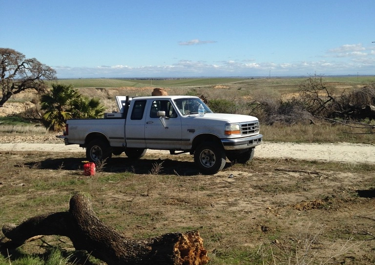

Oh, and here's the truck

Your truck looks really good. I drove these trucks when they were brand new back in my construction days and have always been impressed. I wouldn't trade mine in on a new one at half the price. Parts are high on these old 7.3's but way cheaper than a truck payment and you can't even work on the new ones without a computer degree. If you get one running right and keep the maintenance up on these old trucks they just seem to go forever. I've got 304k on mine and it's never run better. I'm 64 and don't expect to ever have to trade it in. You can make unbelievable stupid power with these things too. 296k and you're just broke in good.

Really looks good. And I'm sure you had fun working on it. I'd keep it as long as it fits your needs. Plus you can make some real power with these and make it really fun to drive.

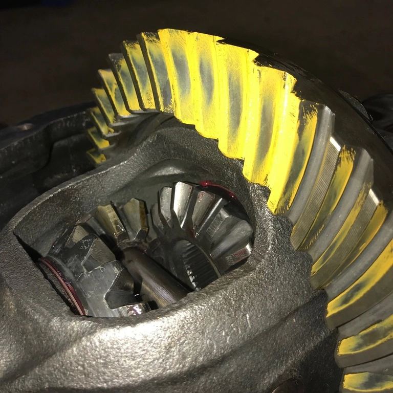

And here's my D60 setup after new bearings and seals. I feel pretty good about the drive side pattern. The difference between the size of the marks is because I didn't have a consistent drag against the carrier when I rotated it
Coast side I'm less thrilled about, but the shop foreman said he thought it'd work. I've read that being centered between the crown and root is more important than toe and heel. Plus, I didn't check the pattern before I pulled it apart initially. Any thoughts? I plan to run it, and if it whines I'll tear back into it. This is my first diff so my fingers are crossed.
Also, backlash between R&P was the same as pre-disassembly @ 0.008"
