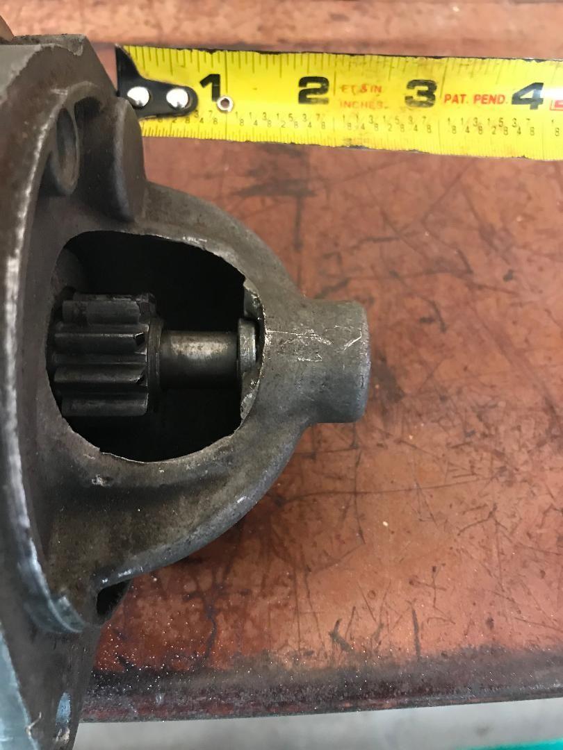

starters i've tried
Originally Posted by azul_grande View Post
Short version: Had the 360/NP435, swapped in 460 and kept NP435. Found a 400 bellhousing on eBay, bought the L&L flywheel/clutch kit and sourced the motor plate (or starter indexing plate) from Jeffís Bronco Graveyard. Another slightly relevant item is I put FItech fuel injection on it at the same time.
So so the first starter on the 460 was from the guy I bought the motor from and he ran a C6. It was acting up from the beginning and we knew something was wrong. L&L tech line claimed no difference between auto and manual trans starters but reading on here and on 460.com confirmed there was a difference. So under recommendation of another post I ordered a 9 tooth manual starter for a Ď70 Mercury Cyclone with a 429. I think.
That starter worked for about 5 seconds then if the truck didnít start quickly it would start binding up and struggling. We only had one successful start up, ran it for a few minutes, then shut it down and couldnít start it again. Acted like battery was weak or timing was retarded. Had it running long enough to set the timing and it was revving very well.
Next, bought a mini starter specifically for NP435 from Left Eye Blind. It will not even engage the flywheel. Canít get a hold of those guys to ask them any questions. FYI I bought my headers and motor mounts from them too. Couldnít use the mounts.
Next i I bought a fresh big *** motorcrsft battery and three 2/0 battery cables. Pos to solenoid, solenoid to starter and neg to the block. Installed Cyclone starter again and same result. Acts like itís binding up.
Been screwing with with this for MONTHS. Out of ideas. Took a picture of flywheel today and it doesnít look good after all these failed attempts. Got to be either the starter, flywheel or motor plate, right?
this is the MT starter (supposedly) from rockauto it has a 2" nose cone and 9 teeth and worked the best out of the three i tried but binds up quickly
this is the AT starter that came with the motor when i got it from a guy. it has a 2 1/4" nose cone and 10 teeth. it wouldn't work at all. made grinding noises when trying.
this is the MT starter from left eye blind. it won't even touch the flywheel. doesn't go out far enough to engage.

Originally Posted by JP3 View Post
Make me think you have the wrong flywheel on it. from what I remember a FE flywheel will bolt up to 460 crank but will cause starter problems.
You may be right. I need to call L&L (again) and verify number of teeth. Here's what I ordered from them and what I believe to be in the truck:
what i ordered...
