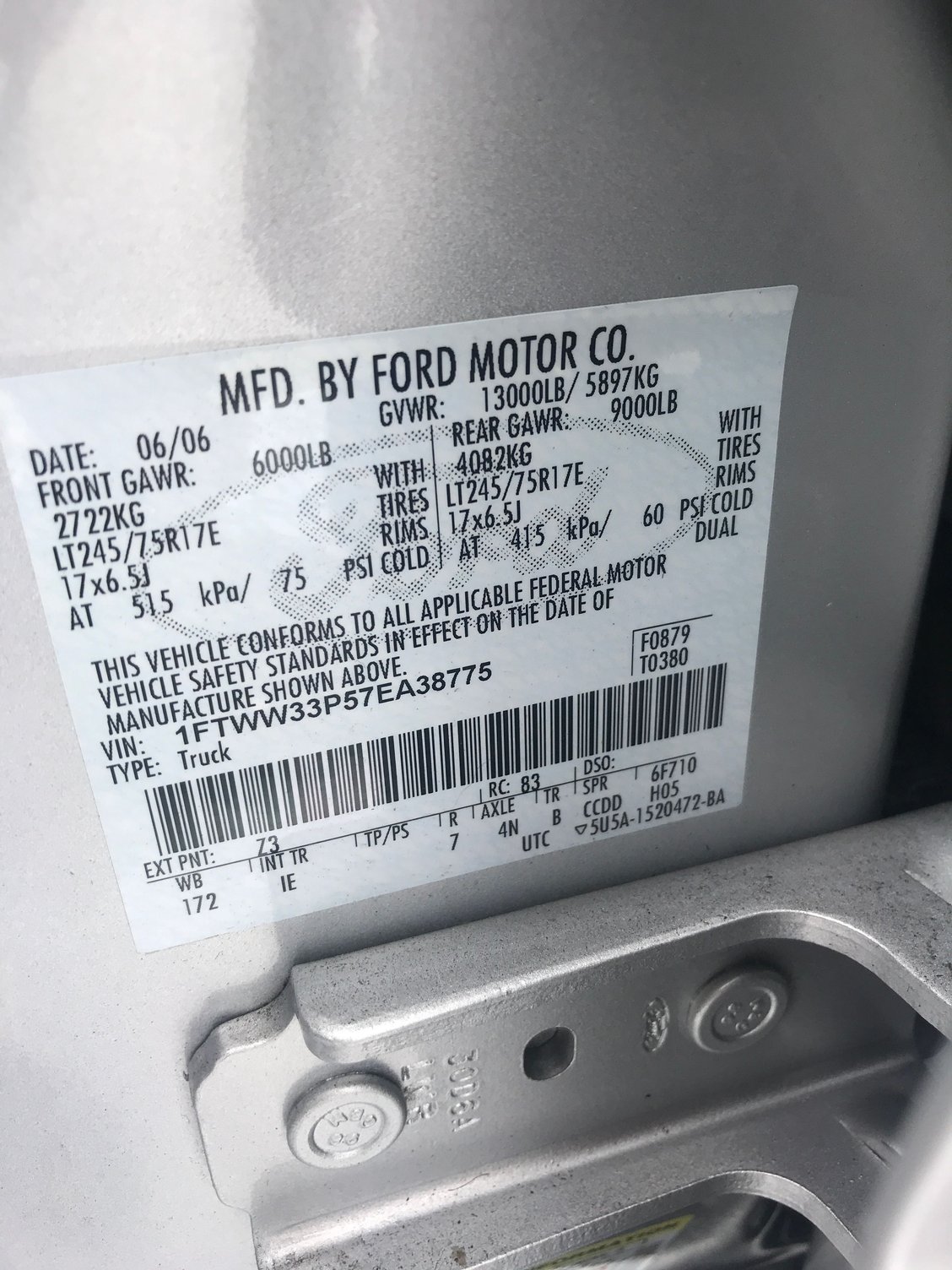

Hereís the sticker.

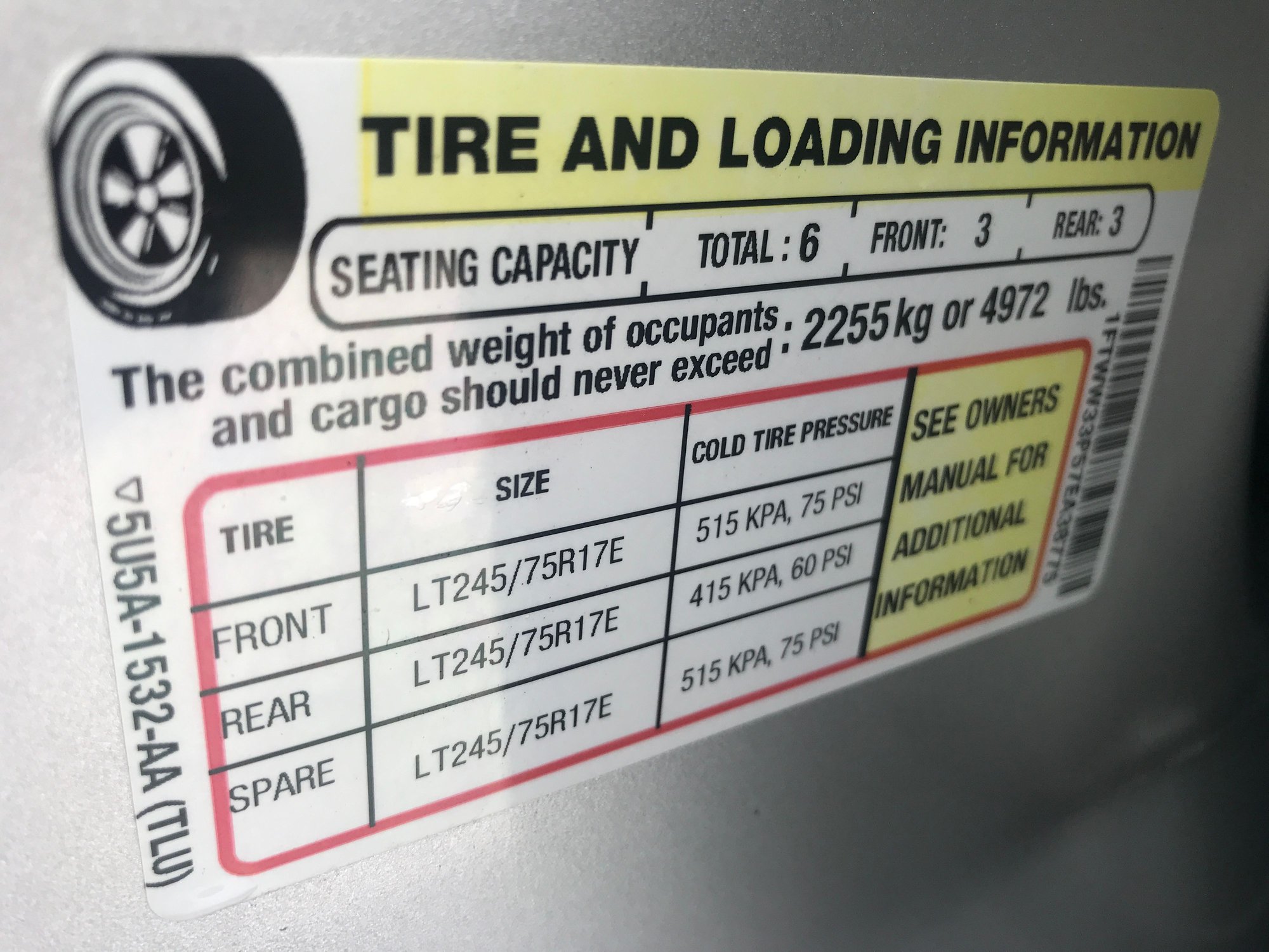

there should be a yellow sticker that's the one that says cargo capacity.

similar to this

GSXR1300, I will have to have the dealership send me another photo as the truck is a couple hours drive and a mountain pass away and we've had snow falling every day for about the last 8 days so roads are treacherous.

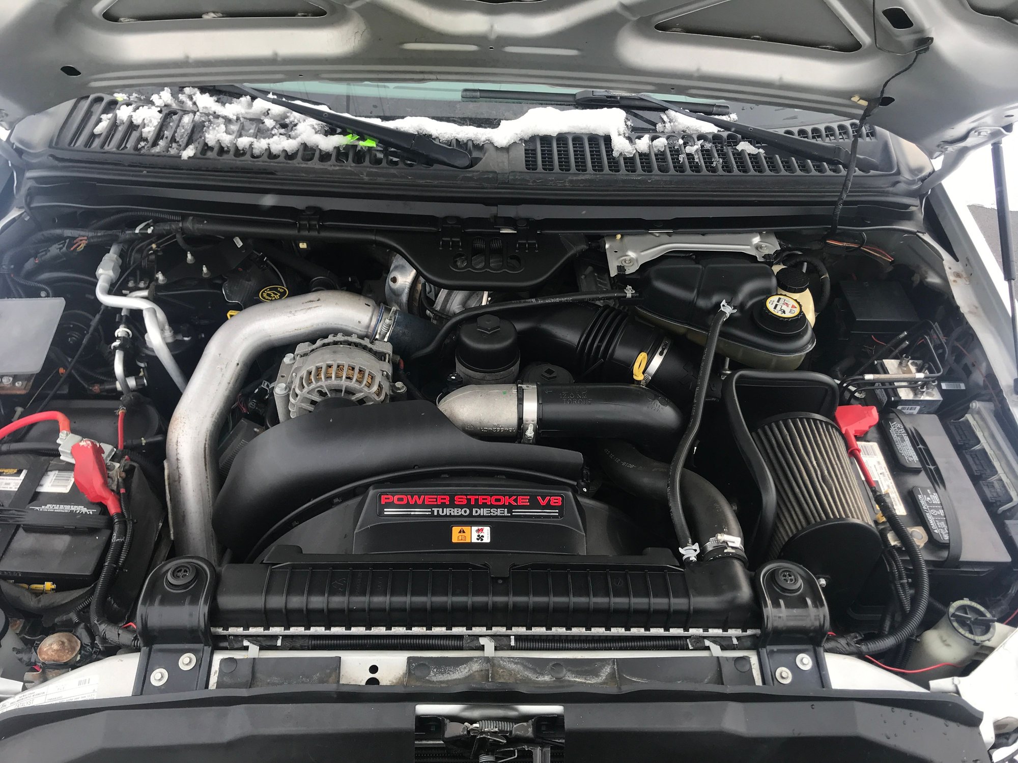

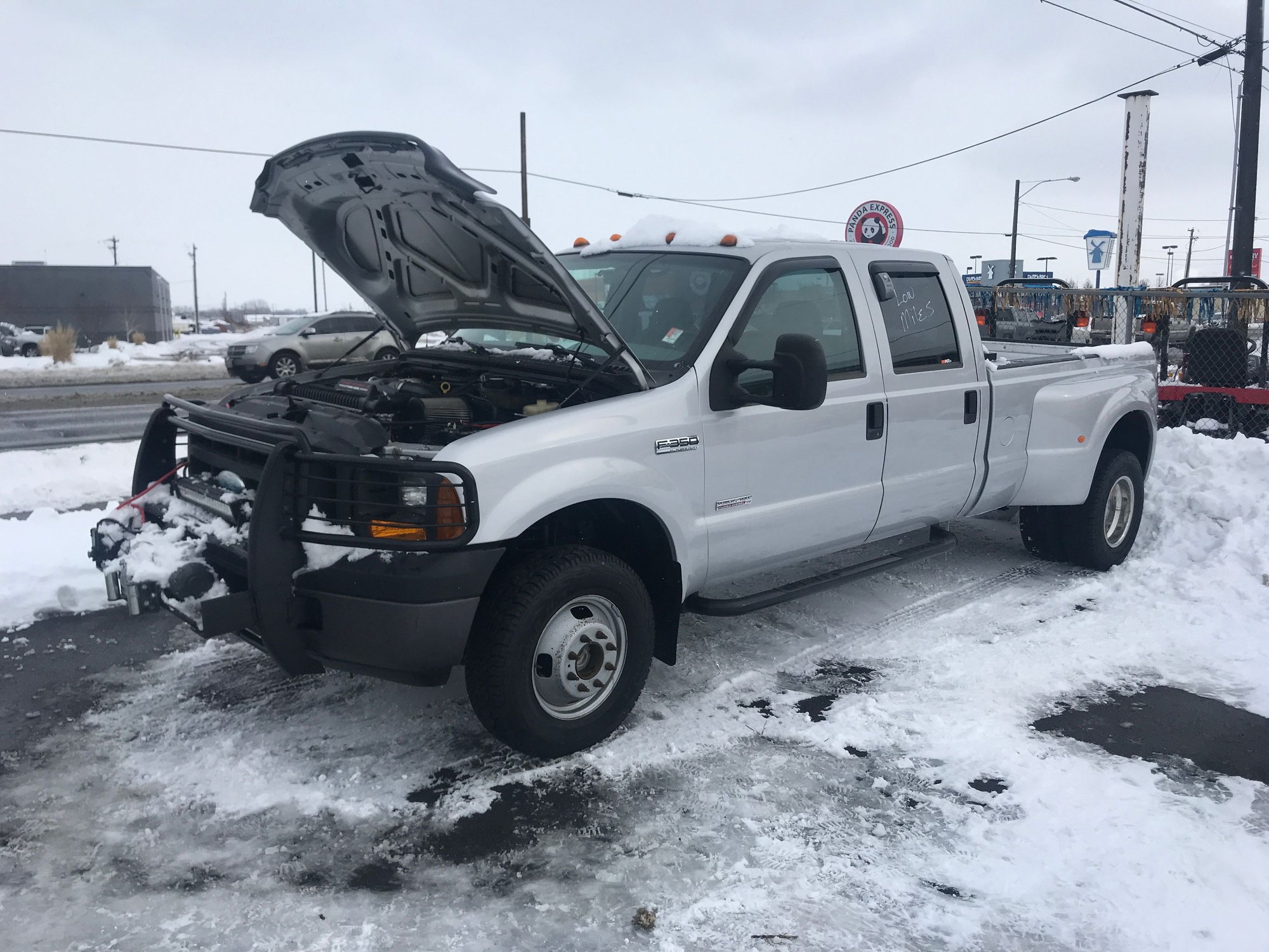

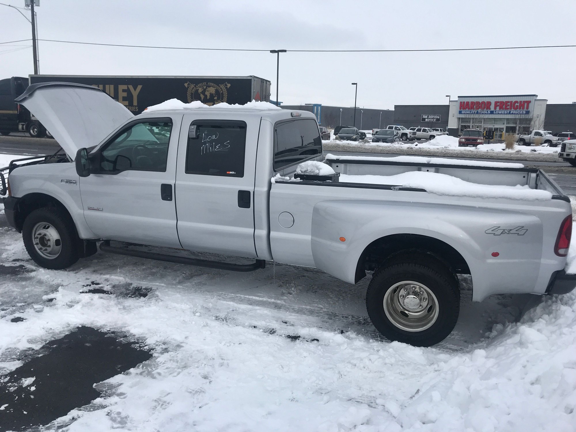

Locally, there is an Ď07 F-350 6.0 Powerstroke 4x4 CCLB Dually with 93k miles that is in excellent condition for $20k. Itís on consignment at a local car lot. Itís owned by a local businessman. He bought it in 2016 with 47k on it from the same dealer. The truck was purchased by the dealership from a local municipality parks and rec. The car lot owner, who is from a local farming family showed me that the same gentlemen had purchased 2 other F-350 6.0s from him along with 5 other trucks over the years. He put this truck on consignment and bought an Ď09 Dodge Dually.
I wasnít really considering 6.0s but this truck is really good shape and appears to have been maintained well. It has had the following replaced/added in the last 3 years: high pressure oil pump, oil cooler kit, intake gasket set, and the fuel pressure regulator. $2,100 in work. Other than a cold air intake, it appears to be stock.
A local diesel mechanic shop did the work. Iím going to call them about the truck as well.
I had a friend with an Ď04 6.0 that grenaded itself. Plus I have read about the issues the motors have. I have shyed away from them for those reasons. What are the thoughts of this community that has more experience with Powerstroke diesels?

The thing that scares the crap out of me the most in those pictures is the K&N filter on the intake. Ford made a great flowing and cleaning filter. That K&N is letting foreign debris into the engine. I would be leery of that. JMO

Te sticker you are looking fore is yellow in color. You can go by the sticker on the trailer for it's weight
The brochure is only general information and basically only covers XL trucks.
Say you have a 10,000 load capacity truck. Then you add the options like heated and cooled seats. They weigh 100 pounds so you subtract this and all the rest from the load capacity until optioned out. Ford does consider all fluids including fuel and one 150 pound driver. you have to subtract that number from the 10,000 pounds. It goes this way till the truck you are looking at is weighed. The yellow has all this information on it. Not tires or vin number.
Gas trucks get the most load capacity because the motor weighs less. The towing capacity has nothing to do with load capacity. Towing is how much weight a truck can pull and a diesel will pull way more than gas trucks.
You do have to look at combined weight when you buy your truck because that includes the weight of the truck and trailer combined.
I went through all this when I got my F250. It made my head hurt. I ended up with a 10,000 package when I wanted the 11,500 truck. I was to late in the season and they 15's were on the way out. I wanted the incentives. I pull a 13,000# 5th wheel with my 6.7. I love my truck. Have towed over 30,000 miles so far.
Larry may have a photo of yellow sticker. It's raining here or i would get mine.
I went and looked at my yellow sticker and I thought it was completely yellow. Been a long time sense I looked at mine. LOL Thefirst yellow sticker shows the weight that this truck can have as payload at 2,799 and the second sticker is a DRW truck with a GVW of 4,972

Locally, there is an ‘07 F-350 6.0 Powerstroke 4x4 CCLB Dually with 93k miles that is in excellent condition for $20k. It’s on consignment at a local car lot. It’s owned by a local businessman. He bought it in 2016 with 47k on it from the same dealer. The truck was purchased by the dealership from a local municipality parks and rec. The car lot owner, who is from a local farming family showed me that the same gentlemen had purchased 2 other F-350 6.0s from him along with 5 other trucks over the years. He put this truck on consignment and bought an ‘09 Dodge Dually.
I wasn’t really considering 6.0s but this truck is really good shape and appears to have been maintained well. It has had the following replaced/added in the last 3 years: high pressure oil pump, oil cooler kit, intake gasket set, and the fuel pressure regulator. $2,100 in work. Other than a cold air intake, it appears to be stock.
A local diesel mechanic shop did the work. I’m going to call them about the truck as well.
I had a friend with an ‘04 6.0 that grenaded itself. Plus I have read about the issues the motors have. I have shyed away from them for those reasons. What are the thoughts of this community that has more experience with Powerstroke diesels?
6.0's are great motors once they get all the common issues fixed. Lots of guys get 300k+ out of the stock engine/tranny.
Find a local mechanic whom is familiar with 6.0's to look at it before purchase and he should be able to tell you all that will need doing. I would ask around, most mechanics don't understand 6.0's, even diesel speicifc shops. Typically it's about $5-6k in upgrades/repairs if they have to do everything.
For what you are looking for I think that 07 looks like a great deal. I would get a repair estimate and negotiate that out of the price.
The 6.0 forum here is outstanding for help. Go read up on their stickies to get familiar.
That engine looks stock except for that K&N. They let thru dust and it can "dust" the turbo, requiring replacement. Go back to the stock air cleaner.
Also it looks like it might have green coolant in it. That could be a big problem as the green coolant can't handle the high temps thru the EGR cooler. These came stock with the "gold" coolant and a lot of guys go to the Red ELC coolant as it's completely silicate free (gold is "almost free"). If it's got green there's a 99% chance it will need an oil & egr cooler.
