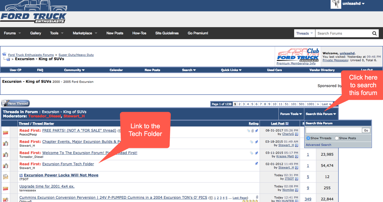

Charles, Have you explored the Tech Folder up in the "Read First" section at the very top of the EXcursion page yet? There are tons of valuable links located there for almost everything you could think of having to with your new wagon. Stewart has done an Excellent job compiling the Tech Folder here.
Tom, Chrales et al, Here's the location of the Tech Folder. Please feel free to spread the word!! You can use this link to post anywhere. I'll just keep this screen shot hosted for ever
