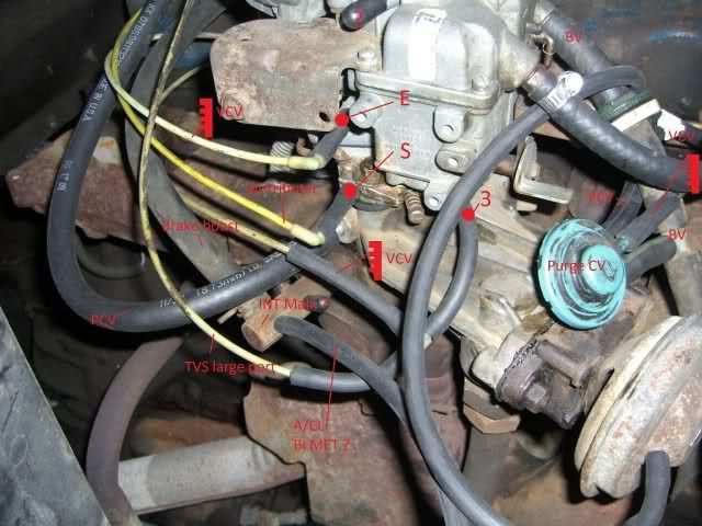

It appears that the distributor vacuum hose is attached to the lower vacuum port, which is most likely manifold vacuum. This will cause the ignition timing to be advanced and will raise the idle speed, which could cause the "running on" condition.
Looking at the photo where you are showing the vacuum hose and where it is connected on the carburetor [post #12]... the vacuum "tree" which has about 6 outlets, is the one FuzzFace2 spoke about. There is a vacuum port on the backside of this "tree", which is pointing toward the cab and is nearest the engine and exhaust manifold. It has [had?] a rubber cap when new, but often falls off or is severely cracked after 30+ years of exposure to high heat. It is difficult to hear it hissing due to the exhaust and spraying with carb cleaner sometimes does not find the leak due to its location. If this port is open, it will cause a significant vacuum leak which will raise the idle speed and will cause poor running and can cause "run on".
Going to have to disagree. That's the spark port, it's hooked correctly.

Thank you for the correction.

Ive got 5 caps on the tree. That i see. Are any of these the ones you were talking about?
Yes, the one on the left [towards the cab] and nearest the engine.
