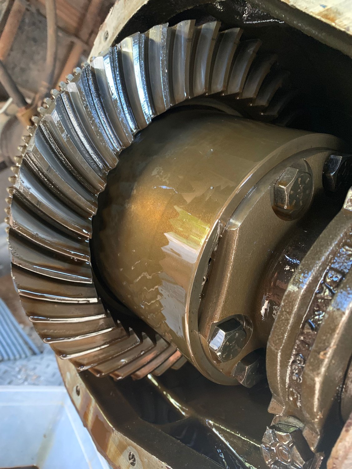

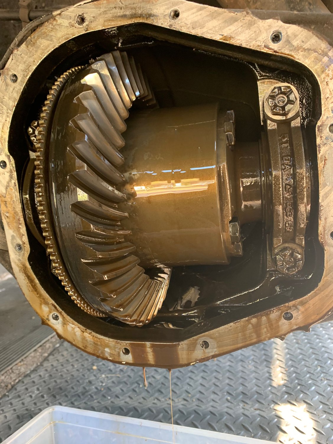

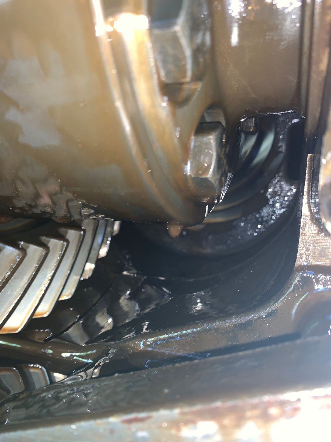

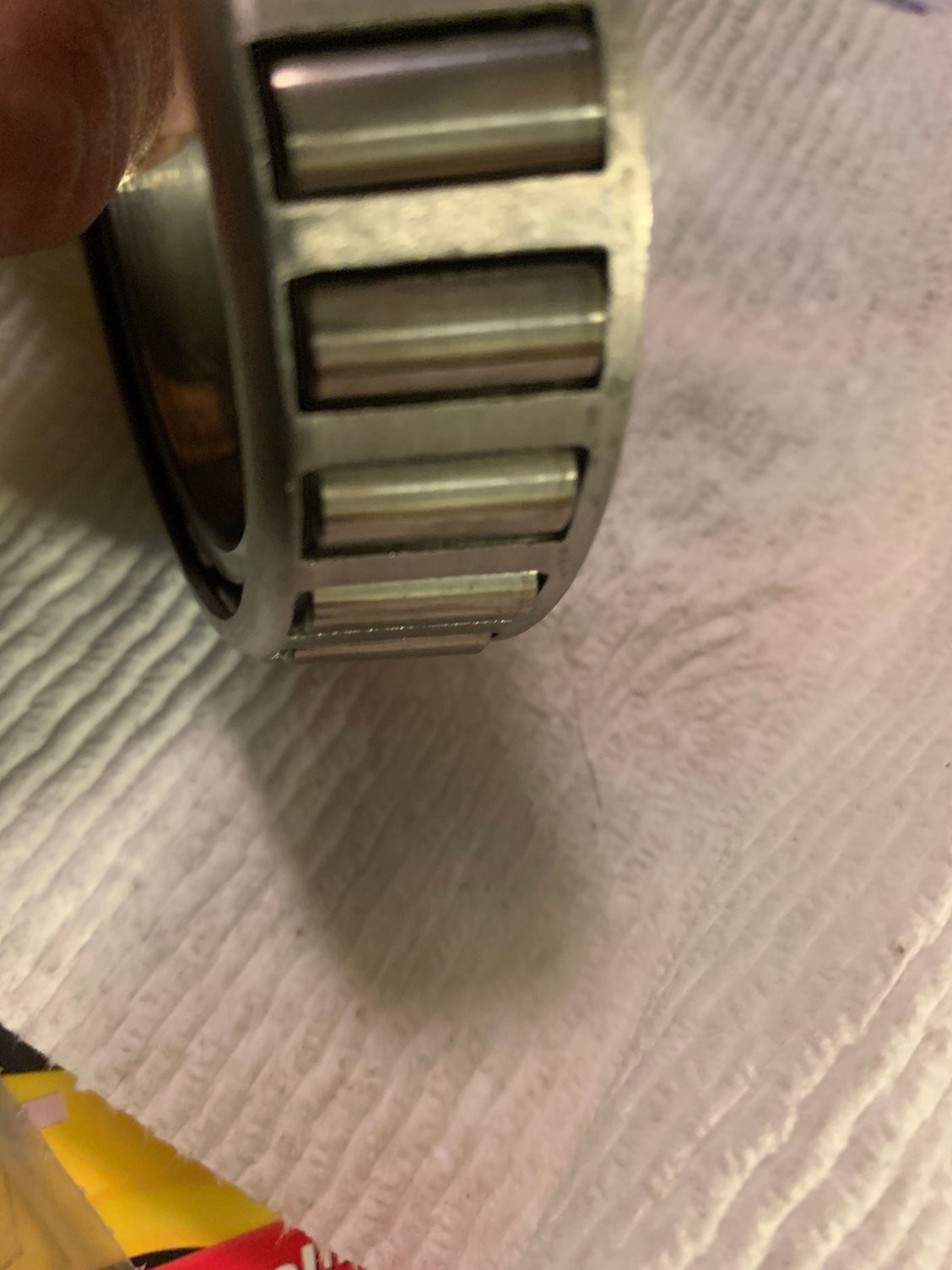

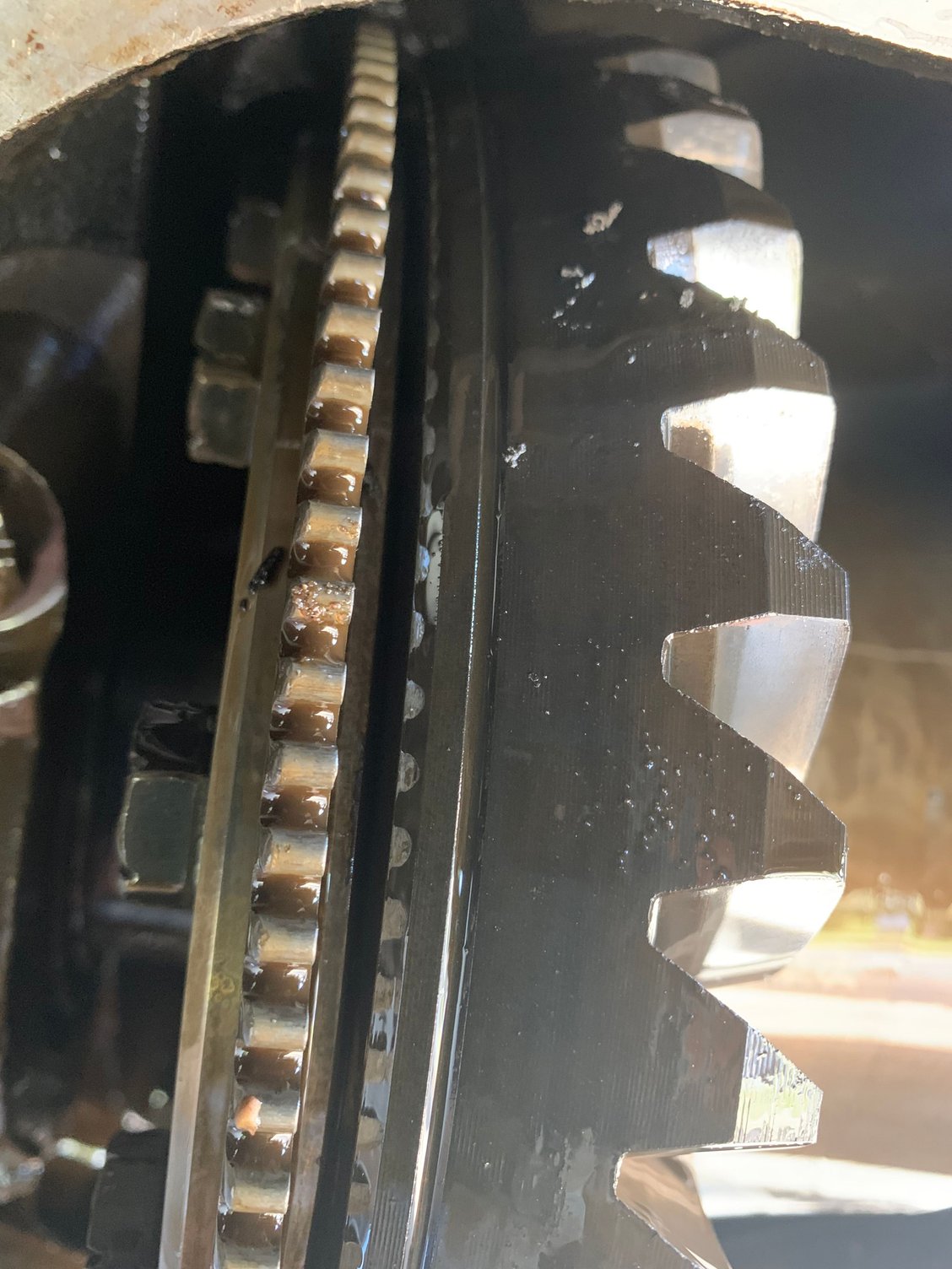

Here are a few photos I wish inhad
some with the metal pieces from last night I wiped the hub and the rag became shiny.
Timken brand bearing may not be original.
There were heavy metal shavings both bearings appeared fine
Fluid looked dark not nearly the amount and size of shavings present in the outer axle. Maybe the shavings were part of the seal?

If you had new gears installed the the gear oil is going to be dark and have some metal dust in it, that is from the gears breaking in. You are supposed to change the gear oil 500-1000 miles after you put new gears in. Backlash is easy to measure with a dial indicator it. On a Ford 10.5 .010-.016" is within spec.

Do not attempt adjustment at this point. The motion in your video is normal. If they made it so it locked up tight, stuff would break.

You say there's metal in the oil and none on the magnet; where did the non-ferrous metal come from?!? I can't think of any non-ferrous metal friction parts in an axle. I've seen some lubes that look like they have metal in them so it could be some goofy oil the shop used.

I tried the let off test and will try it on the highway today there was no noise at low speed The only time it clunks is when accelerating from a stop. The magnet had some metal on it, however the amount of metal in the hub was far more than the magnet. I was using a pick to scrape the corners as it was loaded up in the hub. Previously the pinion bearing fully failed and maybe the metal was from that. The guy that did it is an idiot that brags he does 15k oil changes on his 6.4 and poisoned my family with beliefs you don’t need maintenance!!! Had to tell em when your current car and the next one is garbage I’ll have the 7.3, a boat and 911 running strong! (Thankfully after enough ballistic yelling at them they don’t go to that guy any more work. A man can can only here you didn’t go to school for mechanics so you don’t know so many times. Time to get to work w my degrees in psychology, bio, and public health lol 2 Yamaha 350s are awaiting service and sea trial!

You're in the back rear right? And if I have my bearings straight you had that toasted oil slinger in there? The rear provides the lube for the hub bearings but I don't know how much oil flows the other direction. Is it possible that the metal you found in the hub came from that oil slinger and your carrier is fine?
