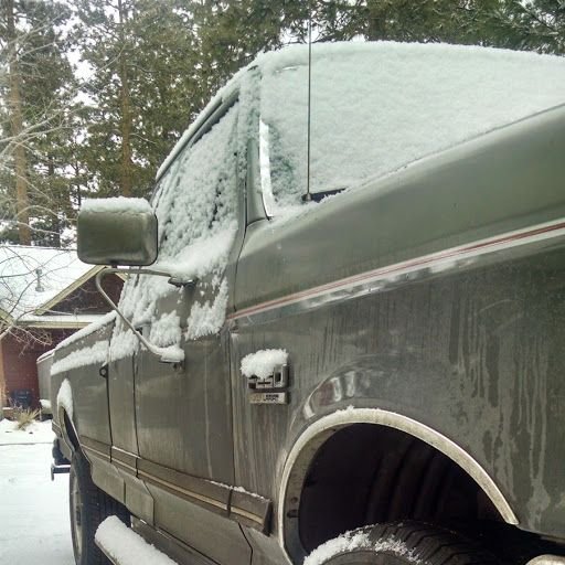

Hi again, reporting in on the new leaf spring install. There is a big difference truck sits higher in the front and drives more solid and not too stiff. Seams very positive, I was a little worried it would be a waste of time & money but am happy with the results.

Hi Jan, Before and after pics would have been a good idea, but....... no. There was only about a quarter to a half inch unloaded under the stops before, now a little more than an inch.
When driving the hood sure seems higher. Not sure if it's possible but the wheel wells look like they came up at least a couple inches.
