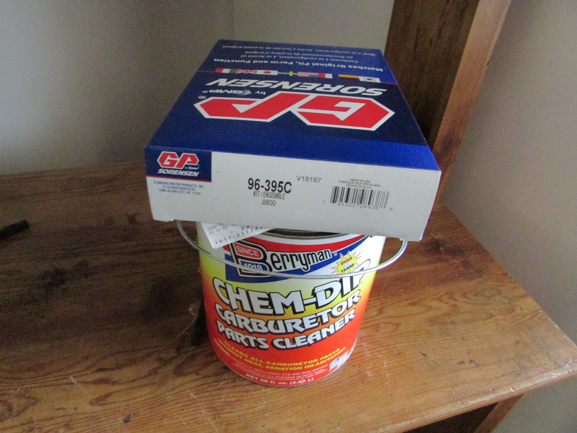

  #103
Old 02-11-2019, 04:03 PM
1981 F100's Avatar
1981 F100
1981 F100 is offline
Join Date: Nov 2018
Posts: 198
1981 F100 is starting off with a positive reputation.
Replacement E3TE-AAA carb for my truck
Spotless float bowl
I think it's carb replacement time, while I was out today it got so bad I could barely get 15 mph out of it. So bought a nice clean E3TE-AAA carb for $30 and a kit. plus a pail of carb cleaner. Took top off and the bowl was spotless! Not bad for a $30 boneyard find. Now, how long do I soak everything in the carb cleaner?
  #104
Old 02-11-2019, 04:54 PM
FuzzFace2's Avatar
FuzzFace2
FuzzFace2 is offline
Join Date: Nov 2015
Location: Angier, NC
Posts: 9,721
FuzzFace2 is a name known to allFuzzFace2 is a name known to allFuzzFace2 is a name known to allFuzzFace2 is a name known to allFuzzFace2 is a name known to allFuzzFace2 is a name known to all
It depends on how dirty it is.
Mine was not really dirty just leaked from drying out when the truck was apart.
Think I did it for about 2 hours, looked it over used a acid brush to hit bad places, soak another 30 minutes then pulled and rinsed.
I may have tried that carb just to see how it ran being it looked that good and maybe rebuilt the one from your truck.
Dave - - - -
