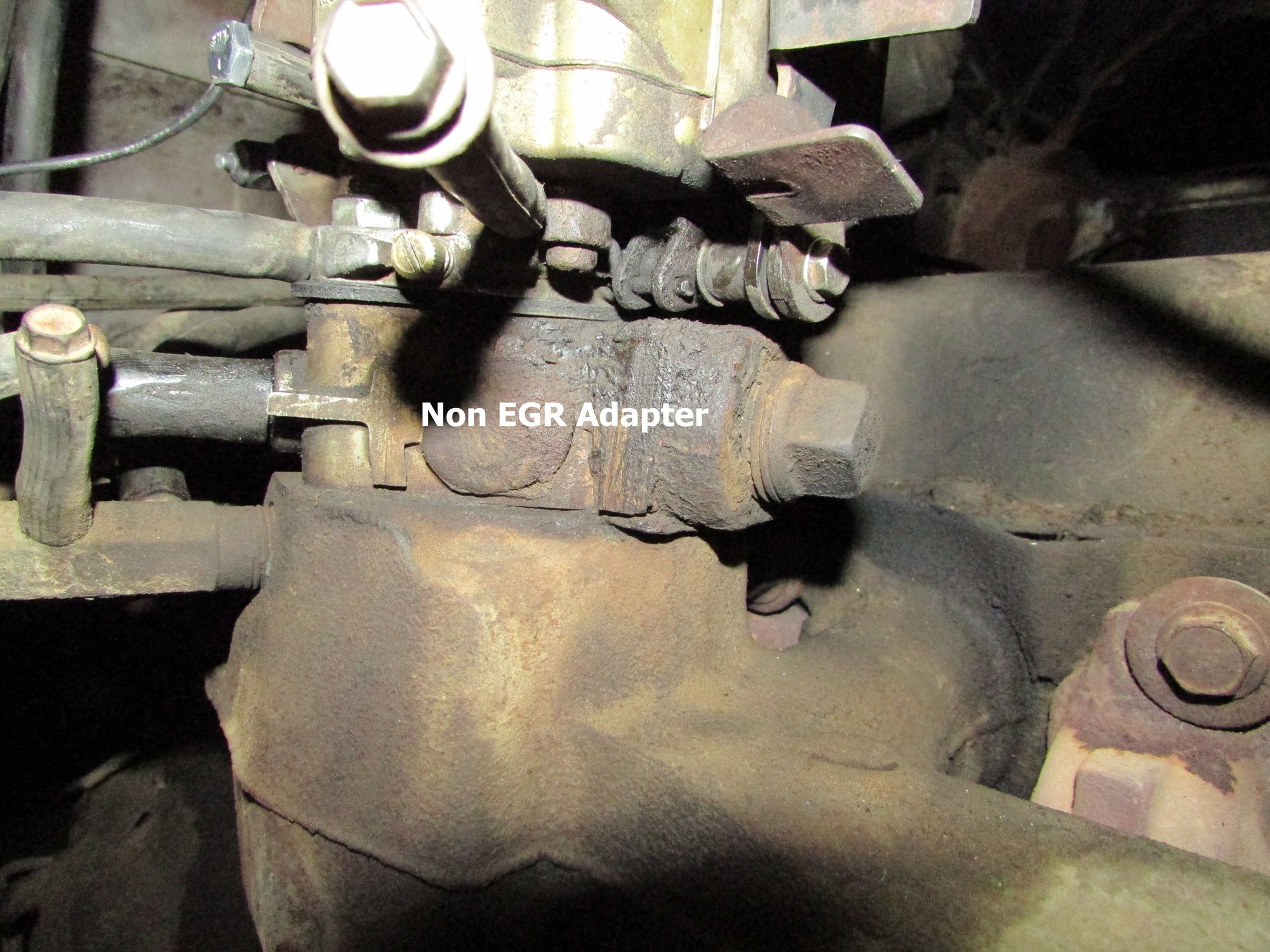

How is that? Got a picture of this?
Are you sure it is sealing? I know of a carb adaptor on L6 motor, stock intake to holly v2 carb that you have to check really really close as it leaks at the adaptor to intake bolt holes that cause a vacuum leak.
Dave ----
Ask and ye shall receive, here is a photo

is that a boogered plug, excessive welding, or quicksteel putty?
Danged if I know, that was on the truck when I bought it. I can take it off in the morning for a closer look, I wonder if that was an EGR one that was butchered? They have the power brake hose going into it, instead of the vacuum tree on the manifold. Heck this could be the culprit
It is. been chopped and hole has been plugged. Hit a high spot with a file, if it is epoxy based it could expand and contract and lose it's seal. Could be hiding a vac leak.
So go get a good EGR adapter, then make an EGR blockoff plate? Maybe that will solve this issue
Or could do this when off
I picked up a freeze plug from the auto parts store that fit the port in the intake, a little sealer and drive it in.
I then put the EGR plate back in place so it looks like it works.
Check the gaskets between the plate, intake and carb.
Dave ----
