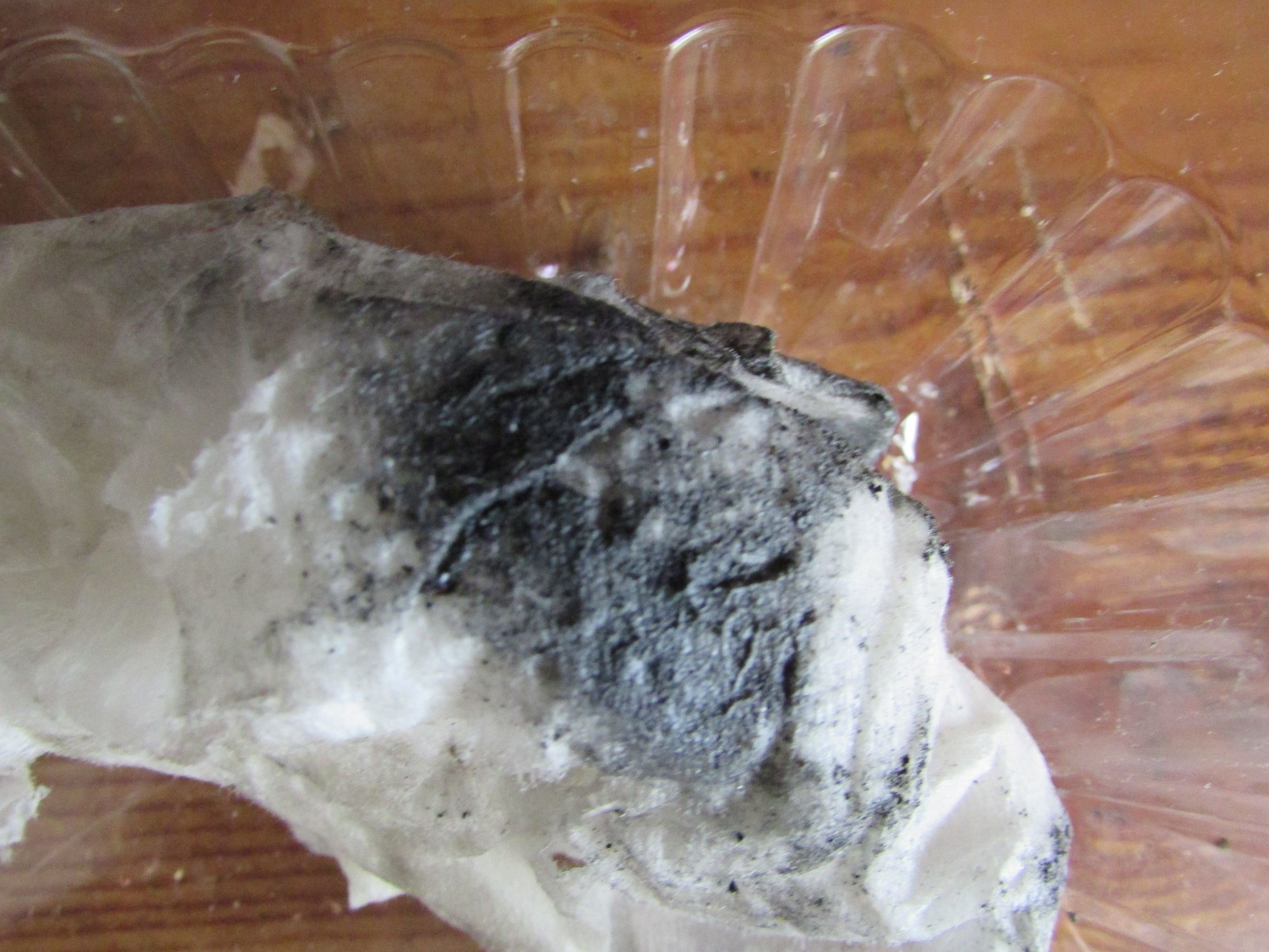

I did not see posted a new fuel filter and from the looks of that rag a new filter is needed big time ........ you do have a fuel filter between fuel pump on motor and carb right?
What ever that is it does not look good.
Dave ----

That was after I cleaned the carb. ALL new line from the clean temporary tank, to the fuel pump. New filter. Fresh fuel in the tank as well. I got it going, and still has the very rough idle, but runs smooth as silk as long as I have foot on the gas.
