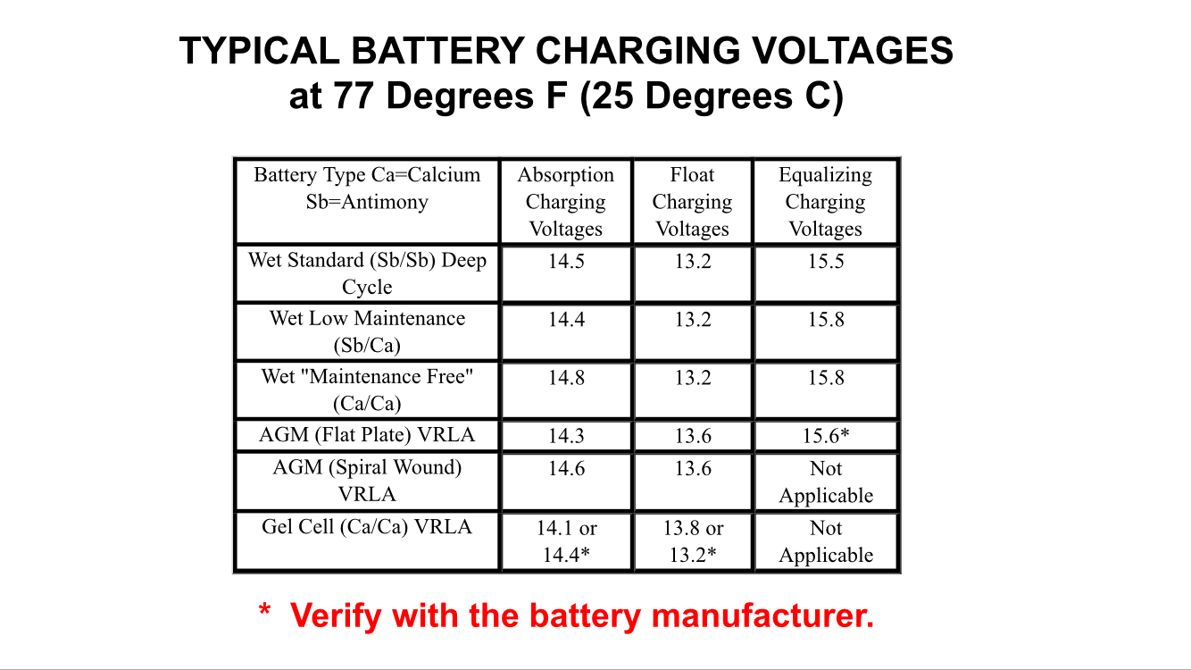

Well, someone also has to consider the stages and values of those stages for charging and maintaining a battery as well.

You are correct. I am just stating the 'ideal' float voltage for battery tenders. I didn't make that clear in my previous post. Thank you for the info check Sous.
Typical battery charger voltages are set much higher because they are meant to charge a battery and not maintain it. The higher voltages charge the battery quicker - at levels within reason. They are designed to be removed after charging the battery and that's where tenders take over. The tenders I use charge at 1/2 amp maximum and the voltage output is adjustable - they are homemade from emergency lights.

Well let's define our terms here. That's the ideal float charge voltage for standard lead-acid and maintenance free batteries at 77° F, just so everybody is clear on that. I know that's what you meant, but. As the temperature goes down though, even the correct float voltage changes and a correction factor is applied. This could be important to consider when storing a battery in an unheated garage, a well discharged battery will freeze.
13.2 is of course not anywhere close to a charging voltage, at any temperature, in case anyone was wondering. Modern battery chemistry too, is different than the standard batteries of yore, and have different charging voltages especially once an AGM type enters the picture. A few tenths of a volt is a big deal.
It is important to use the correct charger paired to the type of battery being used, and in any case you're right, those cheap unregulated $5 wall wart jobs sound like a great way to start a fire or zap some expen$ive vehicle gee-gaw when it fails!
http://jgdarden.com/batteryfaq/carfaq9.htm#stages
