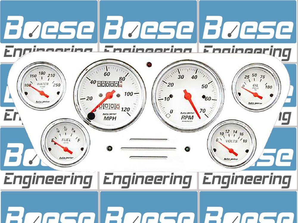

I was just wondering. I was thinking about replacing the entire instrument cluster.
I have seen instrument cutouts for 5 and 6 gauge setups. The 6 includes a tach.
If Iím doing new gauges, maybe I should convert to 12 volt?
Question; (I know this is going to sound stupid). if Iím out and about and the battery dies, I know I can do a rolling start (done that on other trucks). This being a six volt system can I use jumper cables from a 12 volt vehicle?
If it were me, I would convert to 12v
This is the gage panel I have now (the blank aluminum panel, no gages yet)
However, I am tempted to sell it and switch to this one:
from Classic Instruments They're not cheap but they're beautiful!
https://shop.classicinstruments.com/...-truck-package

Wow! The second one is a beautiful instrument cluster.
My original speedometer works. Gas gauge does not. I put new tank and new 6 volt sending unit. How do I check if it is the gauge or the sending unit. Maybe I do not have power to the cluster. The high beam indicator works canít remember off the top of my head but pretty sure oil pressure gauge works. Havenít had it running enough to move temp gauge. Donít seem to remember the voltmeter working either.
