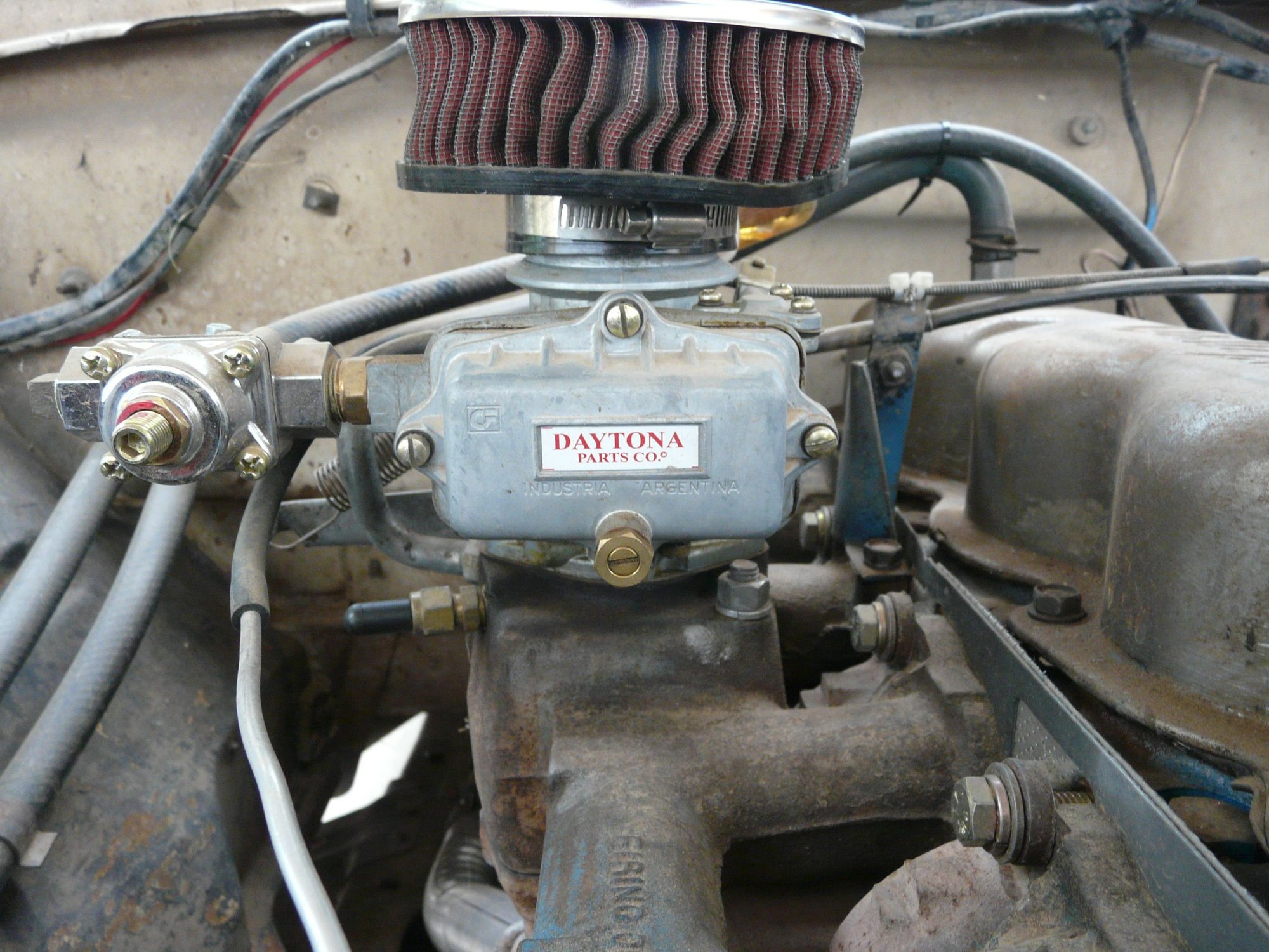

I know someone who put a 4 barrel/offenhauser setup on his 300 and he loves it. A previous PO put an aftermarket carb with electric fuel pump on my 240. It works well. I plan on upgrading from the stock setup in the future
How does that engine breathe with such a restrictive air filter?

I dumped that air filter not long after I got the truck. I felt that it was stupid to have a small filter on an engine that was being used all the time. It now has a standard 10" filter on it. I still have the original carb and oil bath air filter. Just haven't decided on what to do with them. I have a '93 300 that I plan on swapping in in the near future.
